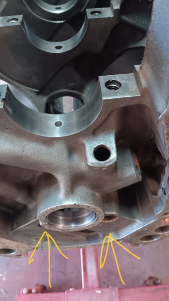

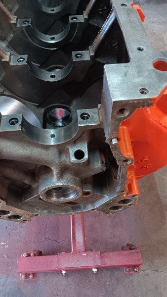

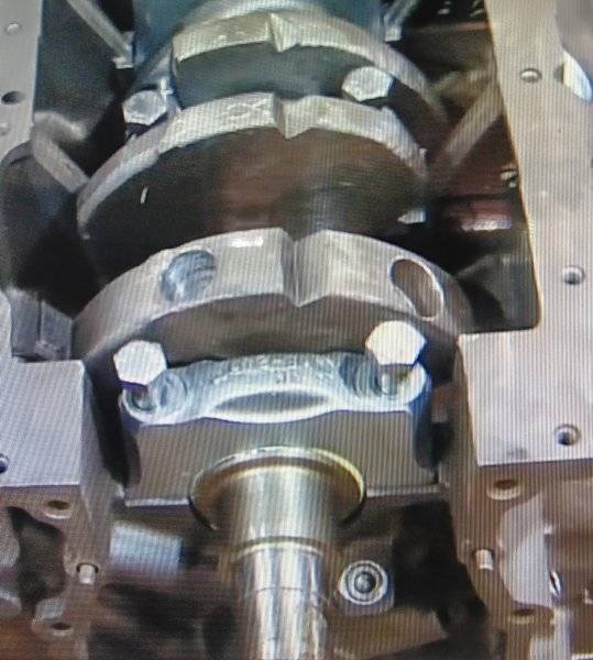

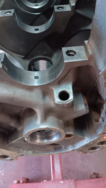

I'm getting ready to install the crankshaft and I noticed a threaded port at the front of the block that I think was open when I tore down the motor 3 years ago. Should I leave it open or install a plug in it? I dumped a little oil down it and it ran into the lifter gallery. I saw that 440 Pete from youtube had it plugged. Any suggestions? The first 2 pictures are my block, the last one is Pete's with the port plugged.
There are more than that one that needs plugged. Two more above cam bore, and two in the bellhousing area around cam bore. All 4 of these are for drilling the passage for oiling the lifters.
Top rear of block are two oil passages. One for oil pressure sender and block the other one.
Yep. I had those 2 already plugged and same with the oil pressure port. Thank you for asking!

All the plugs are pulled to clean and hopefully tank the block. Looks like they are depending on you to figure out what needs to go back???

Don't do like I did and miss that plug it will cost you a set of bearings... No oil pressure. 200.00 mistake on my part.

I did get the block hot tanked so they pulled all the plugs. I'm going with new aluminum 'stealth' heads from 440 Source. Plus a .488/.491 cam from Comp Cams. Topped off with a Edelbrock intake and 750 cfm carb. I thinking 400+ hp!
It's easy to miss. I don't remember taking it out when I tore the engine down. Maybe the machine shop took it out. I hope you didn't do too much damage with the lost oil pressure. :praying:
