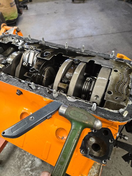

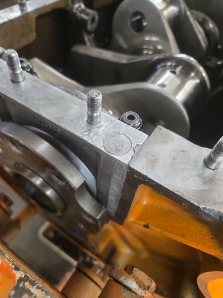

Here is where I think you went wrong. BB 440 has dowel pins for the timing cover alignment, if the pan is on, you have to slide the cover on over the dowels and oil pan at the same time. In a perfect world, it should work, but it didn't this time. You didn't have an oil leak before you did this. Just pull the pan and do it right.
