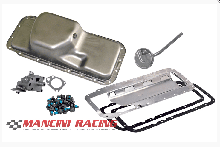

I have a Mancini A-Body Oil Pan Power Package P/N MREOPK547 pan that I was going to use in my 73 Duster big block but ended selling the car.
Would anyone know if that would fit the later B Bodies from 74 and up?? I have the 971 pan in my Dodge Magnum which has the same big block K member as the 74 B. The 971 is fine but the other says it's a 6 qt and is already on the engine.
Any help would be appreciated
Thanks
Good chance it would fit any "B" from '66 on up. Not too sure about the '62-65's tho
It should fit any B-RB in any chassis. The only difference is the scallop for A-body steering linkage. That said I have that package on my 73 duster 470. The pickup dont fit without slicing dicing cutting and welding. Why they cant get a simple pickup right is beyond Me.
