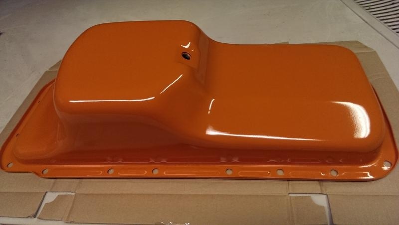

g3511 looks the same as the one I bought. 6 quart pan. Looks like they did some part number changing...why the one I showed isn't listed anymore.
As you can see, requires a different (longer) pickup tube. With the anti splash installed, came out 1/4" off the bottom of the pan. Refer to my photos to see K-frame clearances. Works in my book!

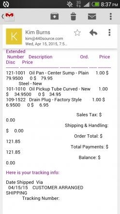

This is the one I bought from 440 Source. Comparing it to the one on the 361 that I removed from the car it should clear. The only thing is I haven't installed the engine in the car yet. It took five quarts of oil + one for the filter when I primed everything. Also I had to modify the pickup tube I bought. You may not want to go through all of that. Look at the shape of this one and others that 440 Source sells. They should have a four plus one pan too.

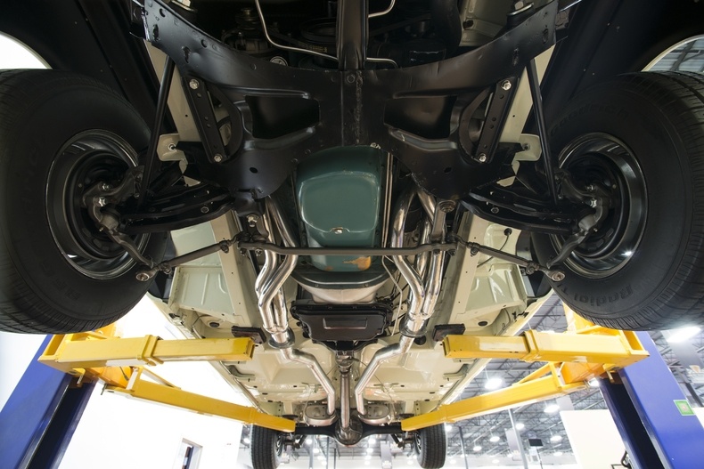

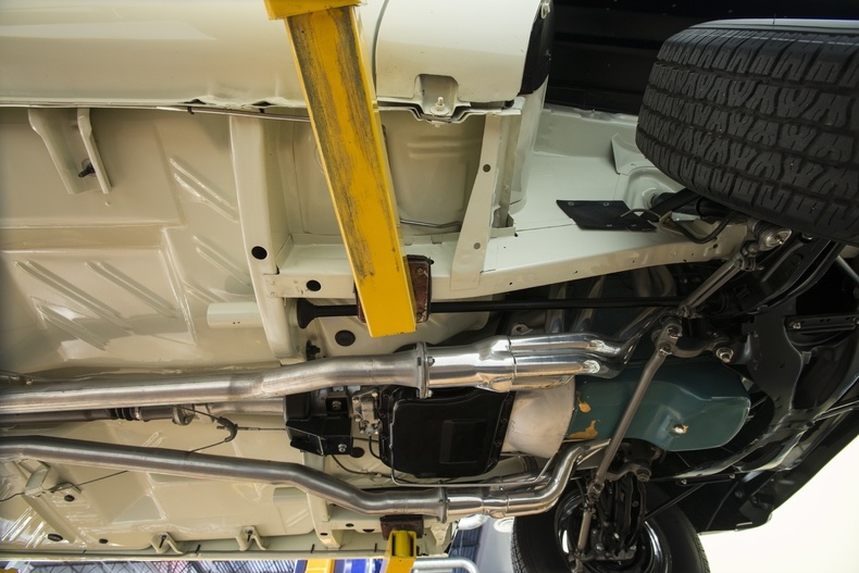

I found these pics poking around the nets today and thought I would post them for reference. Maybe they'll help somebody along the way.
This is a '64 Dodge with what looks like one of the many aftermarket oil pans available on eBay and elsewhere. You can tell by the gold iridium showing where the paint is removed and the taper along the passenger side is the pan. I'm no expert but this could be a later k-member, note the sway bar brackets in the k-member valleys. The tranny mount position may help I'd if the k-member is later or not. idk.

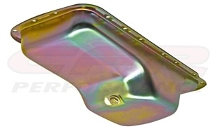

This is the pan I'm referring to -
Thanks for clearing that up. Explains all the room too.
