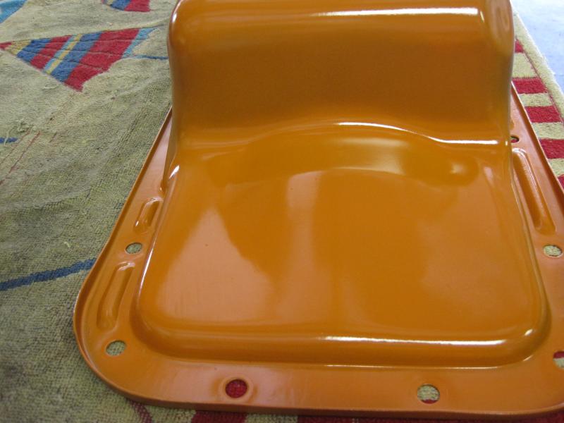

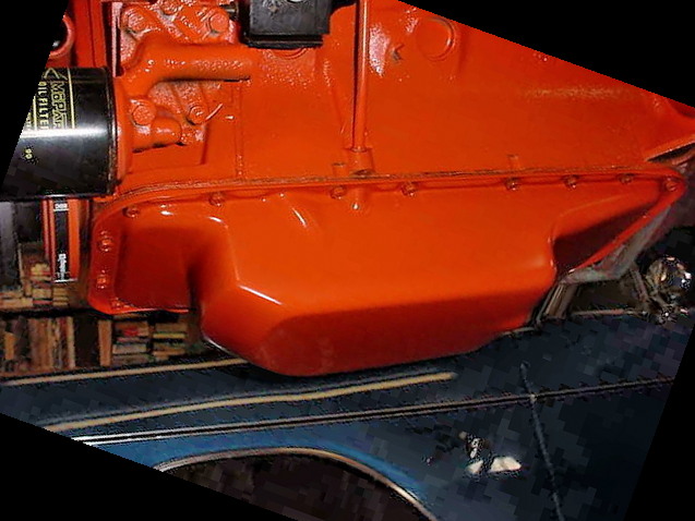

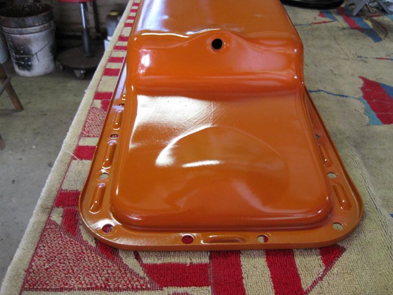

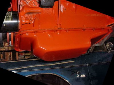

As a followup, here's a few pic's of what was recommended to me...... 005.jpg003.jpg004.jpg

Miller, the orange pan is a stock BB pan for 64 /65. Yes the 62 pans didnt come with the clearance bulges. 63's came with smaller ones.

If I recall correctly, the orange one in the pics I posted and the one I ended up buying from Tony's Parts that looks just like it didn't have a number on them. It sounds though that Mr. Chignikred has just what you need if you want to stay with original, or as Mr. Mosquito13 suggested, you can go aftermarket via Summit Racing. You can also check Tony's Parts via his website to see what he might have available. He's in Delaware & deals mostly in NOS and good used parts and his website is pretty easy to navigate.

I use the Moroso 7 qt pan on my 63 Sport Fury. I have the stock K-frame and it fits good as I did not have to modify anything. I know my front end is up a tad in this pic but you can still see it has plenty of road clearence. Its been on the car since 2006 and has never hit at all. Ron

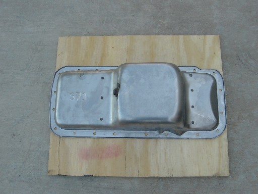

Here is an original Max Wedge pan,no clearance bulges.

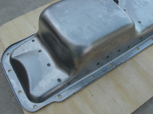

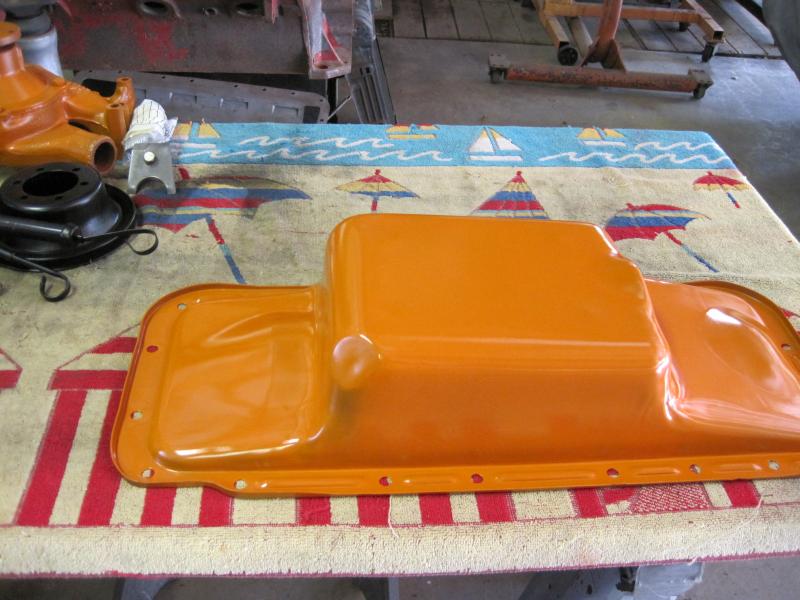

For what it's worth, got the P5007807 pan. If I see things right (and going by Sixpacsteve's photos), it's a 'revised' 971 pan. Even has the stamped 971 on it. But, at the front right corner of the pot, it is re-shaped with a chamfered corner, that might be the clearance needed at the K-member. (Still waiting on the Hemi pickup, so no work on the block.)
Might put a pic up. At any rate, like it makes any dif now, will probably bolt the pan to the block, with my 727, and slip it in the hole. That will tell the story. Wish I had a third hand!
As you can see, front of the pot has been rounded at the corners, the pass side having more shape.
But, dropping the thing in the hole, will tell the real deal. I'll check it soon. Kinda busy rubbing on parts.

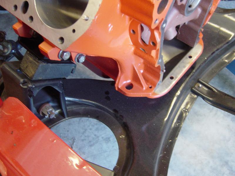

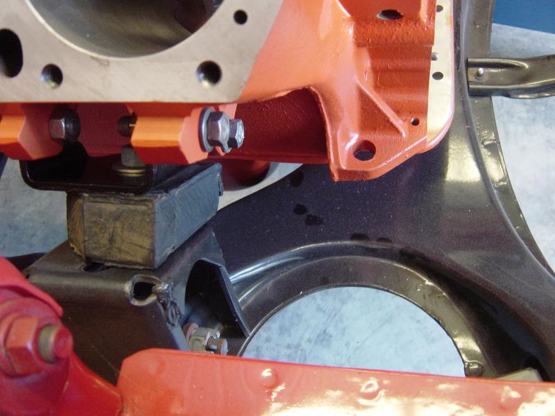

Here's photos of the P5007807 pan, bare block w/ trans bolted up...all three mounts in place.
Plenty of clearance! In the last pic, you can see the baffles (actually one piece), and the 971 numbers. Good to go.
