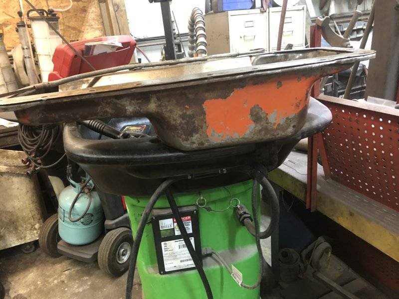

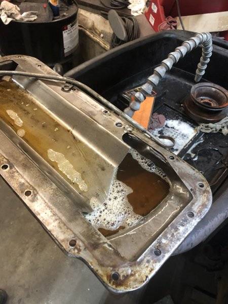

Here’s a dumb question but I need verification. The pan I have “ looks” like the hemi pan. I put 6 qts of fluid in it and it comes up level with the windage tray. Would that be the same pan??
It can also depend on the car your using to be sure the oil pan you use fits right. On my 63 Sport Fury the Moroso 7 qt pan fits perfect in my stock K-frame and did not need any mods at all as it fit right in. Ron
Yup I guess that’s one piece of info I left out. This pan was on the engine when I pulled it out of the car. So in that aspect, it does fit. I am looking for the best pan ( that I won’t knock a hole in going over a speed bump) that I can’t run dry
The Hemi pan is supposed to hold 5 quarts and then 1 in the filter.....so it's called a 6 qt pan. I also add a tad more to it since with the engine running hard, most of the oil is up top.
Well if that’s how they rate it then it looks like I have a hemi pan.

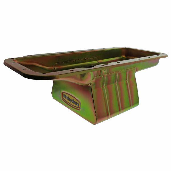

I too am looking to replace the oil pan for my 400 based 500 stroker engine, but I want as much oil as I can get without it hanging below the K Member. Has anyone tried this pan below? It's a Milodon 7 qt. pan. The little flare out seems like a good way to add a quart, but I am unsure about fit with a stock K member.
Any feedback greatly appreciated!

I have been using that exact pan for years, haven't hit a speedbump yet. It IS seven inches deep, compared to a typical 187 pan at about 5.5" deep. I have another seven inch deep pan in the car now, and it hangs almost 3" under the k-member. But, my headers hang even lower, and I like them too, so I'm careful.
The hemi pans add capacity by lengthening the sump, not lowering it, but that doesn't move the oil farther from the crank. Milodon pan should save some power through reduced windage, and add oil supply insurance. Deeper sump and baffles should keep oil from running away from the pickup.

So it is 1.5” deeper than the hemi pan - I guess I need to start taking some measurements to get a feel for how far it would hang below the K member. For a car that will drive across country, I need this to be tucked up nice and tight. This is not a race car, but I do want as much extra oil as I can get while also ensuring I don’t rip out the bottom of it on some bump.
I have a stock 69 440 runner, and the stock pan sump is at least an inch lower than the k-member.
The milodon is in my 62, a hemi pan would interfere with the tierod. Early b's have a different k-member .

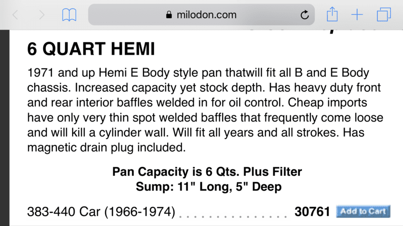

I'm getting a Milodon 6-qt Hemi pan put in my 440, along with Milodon windage tray and gaskets.
From the Milodon site:
Says, 6qts PLUS filter...
It's what I have.
