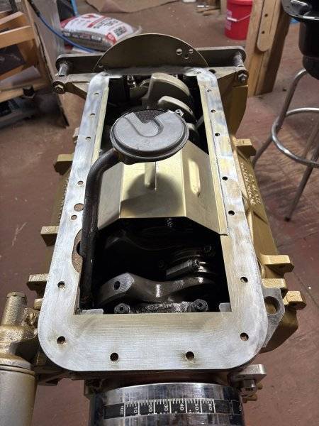

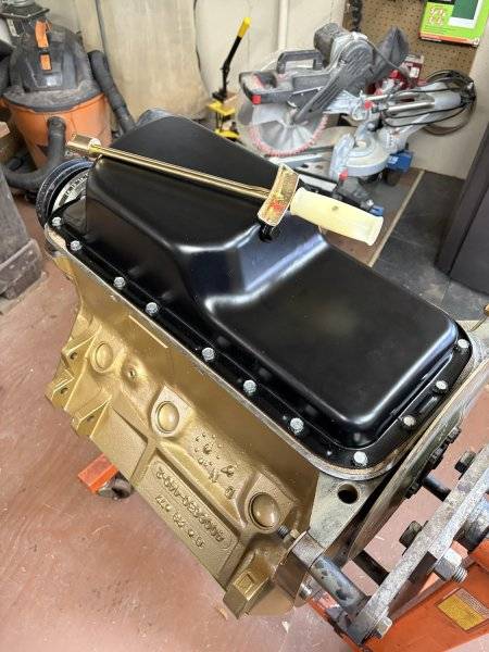

I also ordered same pan. What windage tray you use? I have stock and source440, they dont fitDropped one on the 440 block (505 CID) a couple of weeks ago. I didn't measure it, but it's definitely a sturdy pan.
7 QT oil setup... Pan holds (6), plus (1) in the filter. I use a 1/2" oil pickup, also from 440 Source. It came a little long (which is better than to short), so I cut it back a bit and rethread it to get the right clearance height off the bottom of the pan.
View attachment 1848805 View attachment 1848806
I used the stock 440Source stroker tray...I also ordered same pan. What windage tray you use? I have stock and source440, they dont fit
