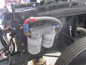

In my tube Arrow with a dragster style pan & kick out used a Milodon alum pump/swing pickup dual line system. It was great. My current system in my '66 Satellite I have a Milodon road race external pickup with the Milodon cover on a Melling pump body. Works really great. Suction line routing could be a little tricky.

I have the dual line system with the swing pick up and 10 quart flat bottom dragster/f.c. oil pan and 3 quart Accusump. No shortage of lubrication. No issues street or strip.
