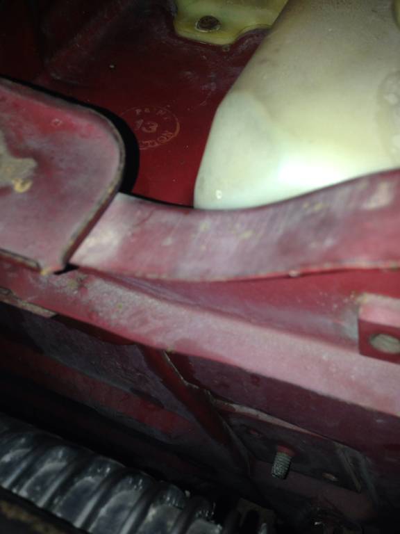

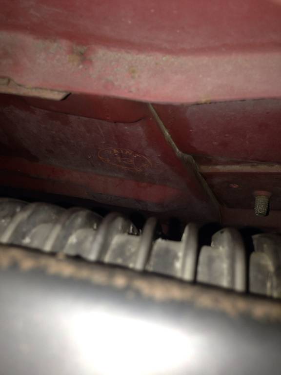

My '66 Bright Red Charger's entire radiator core support is body color. Still has original factory paint inspector's circle stamp, so it looks like there is precedence....
I've noticed the stamp before on the inner passenger side fender in front of the windshield washer bottle, but never saw it on the front of the core support until tonite when snapping these pix...

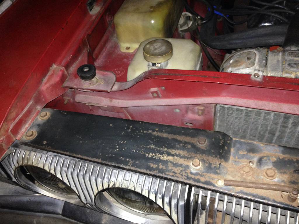

A383Wing's '66 Charger's rad core support front is blacked out, mine is body color....

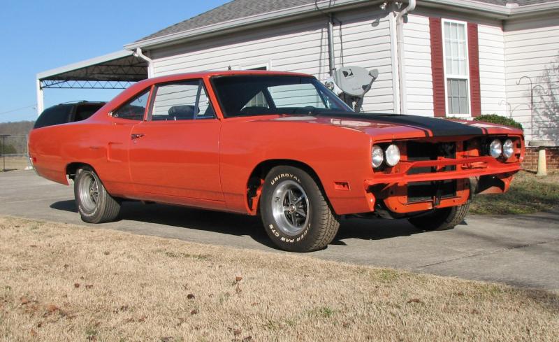

I am doing 1970 Roadrunner, maybe the year of yours and mine make a difference??

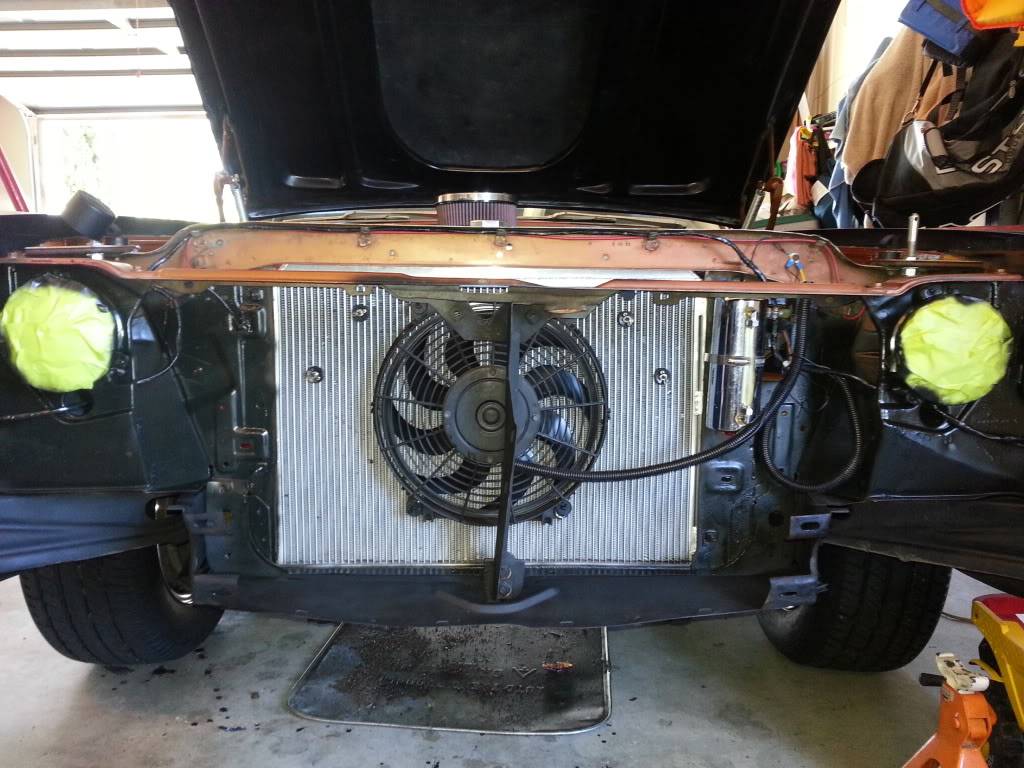

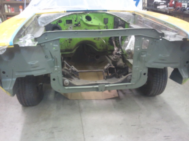

made progress on the core support today. Got it all in primer. Headed for the firewall tomorrow and this weekend.
