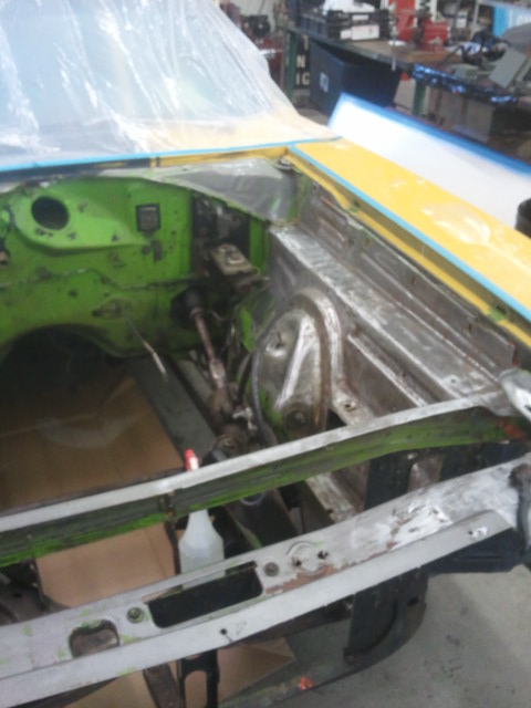

I learned my lesson about even discussing blacking out the engine compartment (Although this car does not deserve the love Im giving it, Im going to paint it yellow, but thats another story...) So, Ive got the paint stripper out and Im going at it. I know from all the restoration photos I have seen with cars on dollys that the core support, fenders, engine compartment, inside of front fenders etc, all gets painted body color.
BUT What happens to the grill side of the core support and head light bucket areas? Seems like that all gets blacked out after being painted body color. I hate to do all the work to strip the grill side of the core support and paint it body color just to paint over it with blackout.

If the paint that's there is not peeling or rusty I would just lightly sand it and paint over it.

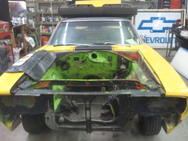

this is what I started out with. black over orange over green so I had to strip the core support and fenders. May do as you suggest when I get to the firewall as it is mostly green.

Certain colors had the factory black out. Obviously the lighter colors would top the list. Sorry, I can't tell you for sure where the cutoff is for the black out, but i'm sure one member of the coveted FBBO Mopar Archives & Dewey Decimal System Association will show up to point out the mask lines for you.
Body color all of it, the grill and bezels will look better with the yellow in the background it will be hard to see anyway with hood closed driving. Looks like you are very close to being ready for a repaint. Take the master cylinder off and the support bracket, the only one thing you are allowed to paint black the MS bracket! lol Don't forget to gloss black you k member.

What's up with the Chevy sign? Are you saving it to patch holes with or something?

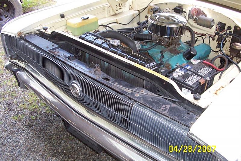

anything visible through the front grill is supposed to be black....if you leave it yellow, it will look like crap
actually, all in front of rad support should be black

My 66 Belvedere is painted flat black over the original body color on front of the core support. Even tho the rest of the car had about 30 million coats of paint, the front of the core support is still original and some of the blue shows through from years of being road blasted but it's not flaking off one bit.
ive taken apart many cars that have had the whole front of the core support black. everything facing forward behind the grill. some didn't even look masked off, just simply bombed. have even seen it on F8 colored cars (dark metallic green) . I think its safe to say 80% of the cars had some kind of blacked out core support.

yea..my OE 66 posted above looks like it was "spray bombed" at the factory...over spray in places...no masking at all
black cars got sprayed also...it was kind of a flat black even though the engine bay and outside were originally black
light color cars blackout dark cars body color.
no...all cars got painted, even darker colors..it's not really a paint...at least it does not act like it...almost seems it's like a sealer..maybe because it gets all the road crap thrown at it first
