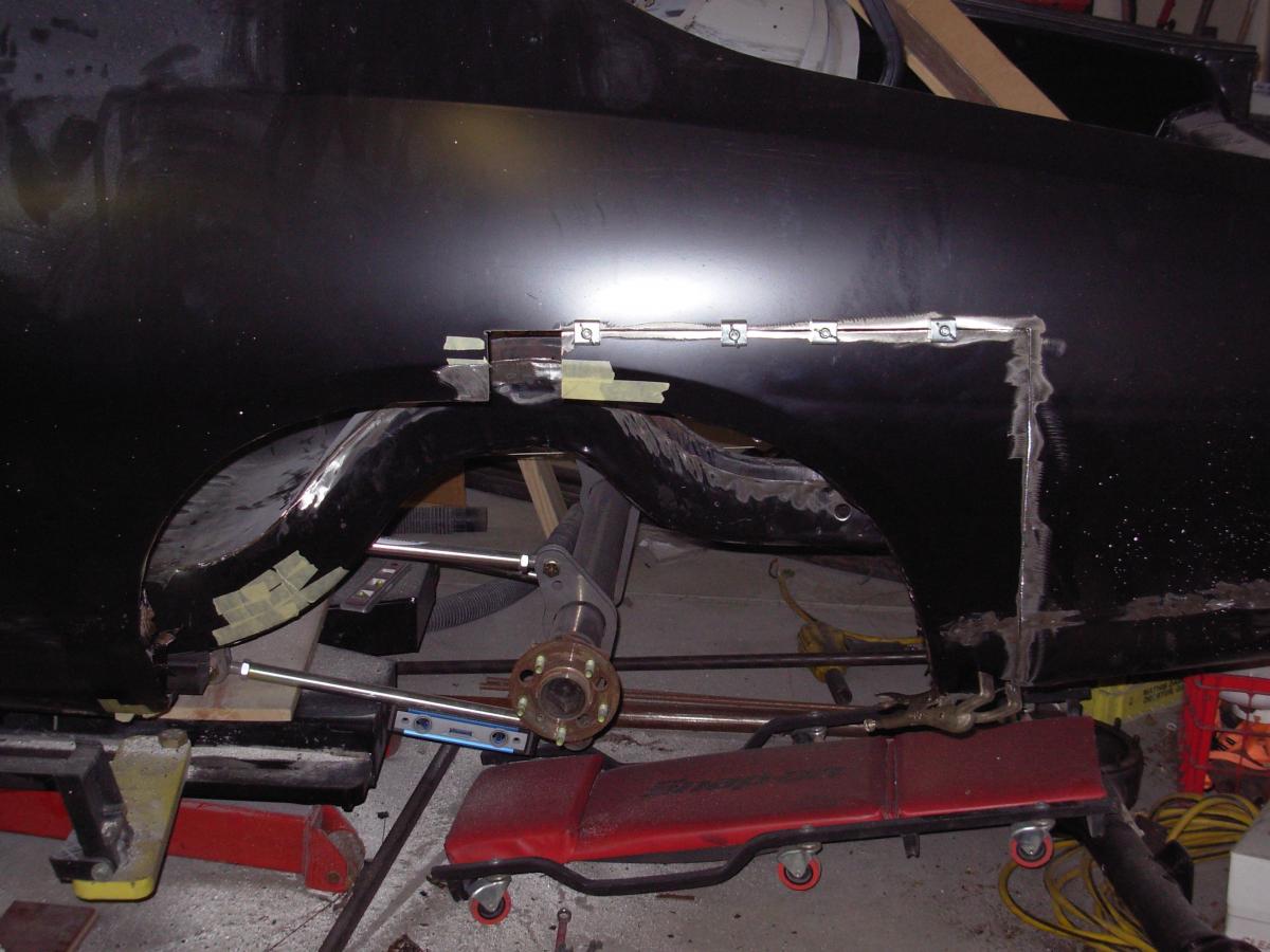

Just to add to the info I but weld all my seams wich allows me to finish my seams much smoother.No laps or flanges for me.

Yeah I guess my but welding doesn't work.I guess the skim coat of filler to finish the stretched qrt is a less quality repair.You might want to flange it and build a few layers of filler to fill up the seam.The added failure point of the back side flange is plus also.:rofl:

Yeah, seems pretty obvious to me that a lapped panel will collect junk and rot, and be impossible to even paint over on the inside behind the C pillar.
