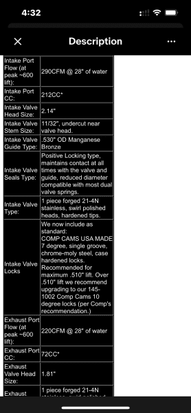

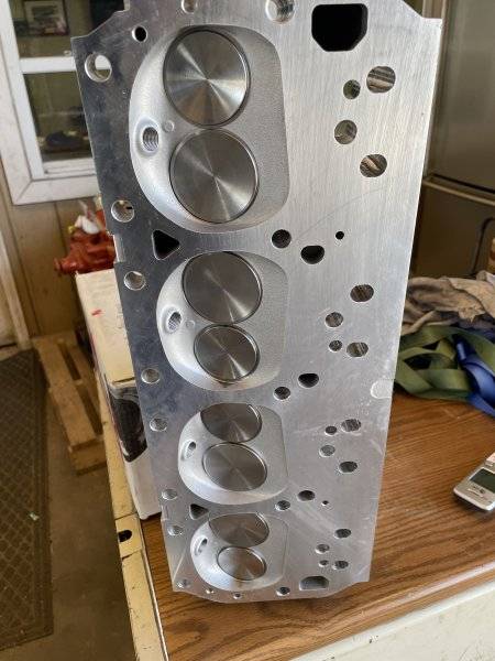

I will be using 440 source heads Stealth heads. Specs:

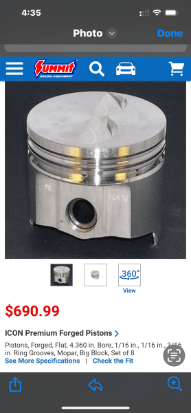

Pistons will be:

Current pistons:

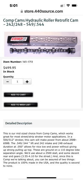

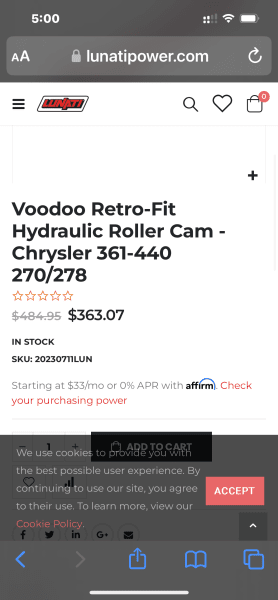

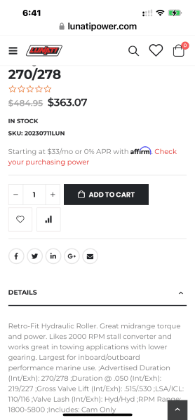

So with all that, I need a cam that:
Sounds cammed, but will work with what I have described. Target compression to be around 10.5:
What other info is needed for Cam selection?
Thanks again, and please accept my apologies for any misspelling or things that don’t make sense. Still trying to get me meds right(evening in emergency room after a reaction to meds that left me unable to breathe properly for about 2 hours. Got an injection of effenephrine and a couple albuteral breathing treatments and I’m back home)
Cam options I’velooked at:

I ordered a converter as outlined in this post and we began pulling off the heads to get the engine specs we lacked. Type of piston, compression etc.
Discovered a broken intake valve and got the cam specs.

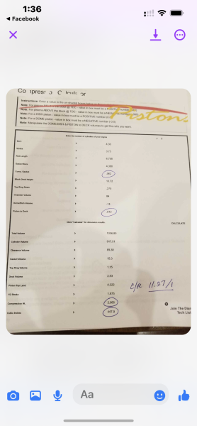

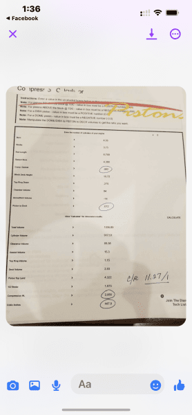

Yes I am getting assistance from a builder and he surmises based on the basic info that it is a 440 bored .040 over. I am getting my buddy to get some more info by pulling the pan and checking the connecting rods and the piston tdc to deck and bottom to get a precise compression number. Then we will look at possibly a .067 gasket to get compression to 11.27:1. (See below)
As for money spent, I paid $3500 for the engine so I think, changing a valve and investing in some cometic head gaskets will still be a good deal.
