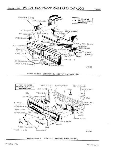

quoting myself to confirm the info... 71 Parts catalog and my 74 parts catalog doesn't share same PNs for these. Neither the diagonals or the lower bar. Diagonal ones are listed in fact on 70/71 catalog as left and right pieces. Could still both work thought but dunno the differences. I know 73/74 bumper assemblies use to be heavier than earliers... maybe thickness... or the provision for bumper guards being some diff due the diff bumper guards... can't tell

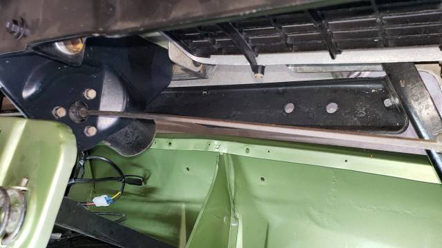

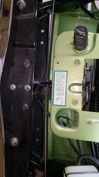

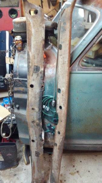

The lower bar on my 72 is just bolted between the bumper mounting brackets, nothing bolts to it. The grille support brackets have smaller individual brackets bolting it to the lower part of the bumper.
The upper one on my 72 is different as well. On the passenger side of the 72 there is a mounting hole that the 73 bar does not have.

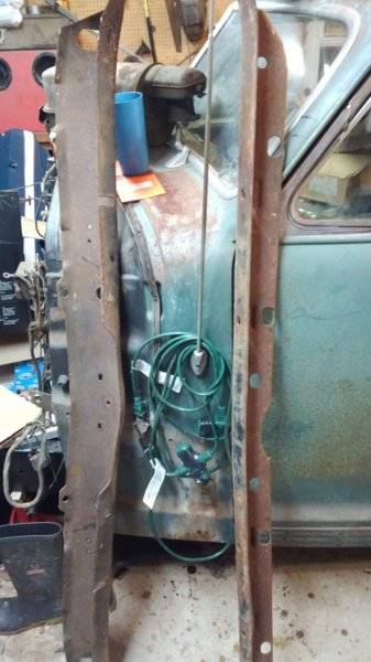

I tried emailing photos but my email is having issue s you need the left one?

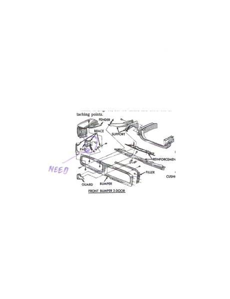

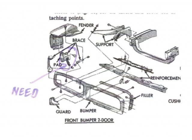

Do you think you might have these little brackets I circled?
Looking at the diagram it pretty much looks like the left one. So I would say yes, the left one. It looks very much like the one in ODZKing pictures too. Thanks for that ODZKing.
Yes, left one... right one seems to be rear bumper!

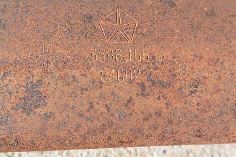

Just curiosity, check for stamped PN... this stamped PN from the full assembly I posted on my first reply meets my 74 catalog
The 71 catalog DOESN'T SHOW a lower reinforcement!!! not even if regular grilles ? aside the bar between Y brackets which is there
Am I crazy then ? I thought that was just for Hideaways ?
