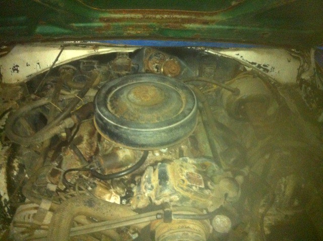

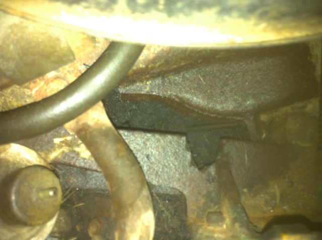

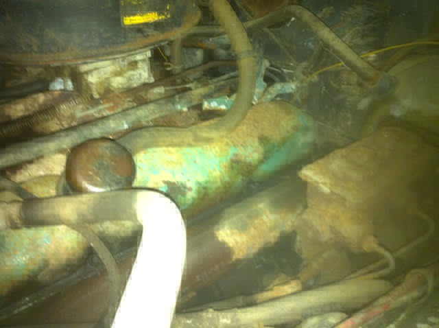

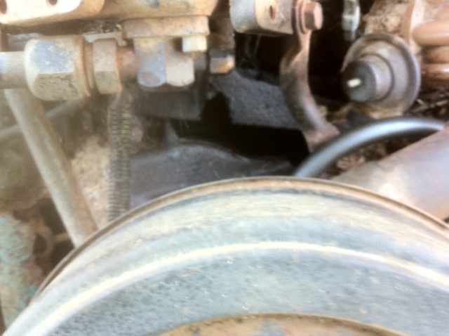

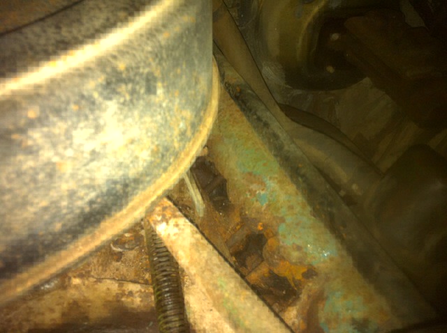

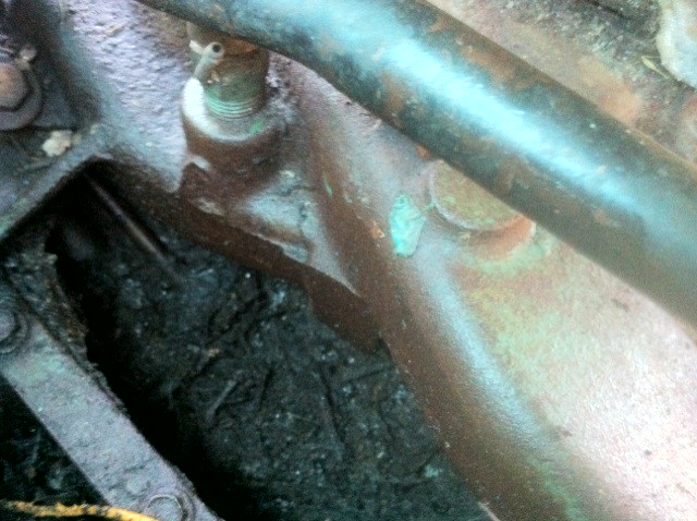

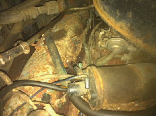

I have a 68 440 that has AC, PB, and PS, all that stuff aside, when i got the car it had been sitting since 1973, and over the years the valve covers have rusted out on the side of the air cleaner, and the valley pan has either rusted out or been removed for some odd reason, when we drove it half way home we noticed the valley pan was gone and underneath was some sludgy old oil. we then drained the oil and what came out was dark watery oil, but no sludge, there is probably a bit still left in the engine but we'll figure that out later, with the valve covers rusted on the inside sides it looks like the pushrods have some surface rust and sludgy substance caked on them and i want some feedback on if anyone on the site has seen this before and if they think the engine block may still be alright. so here we go... Good news or Bad news...

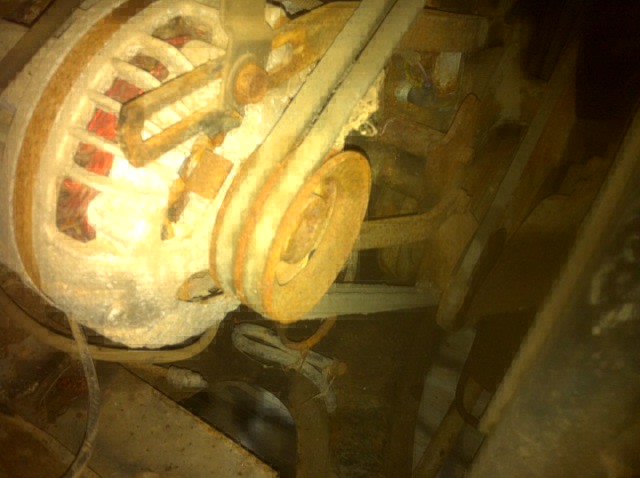

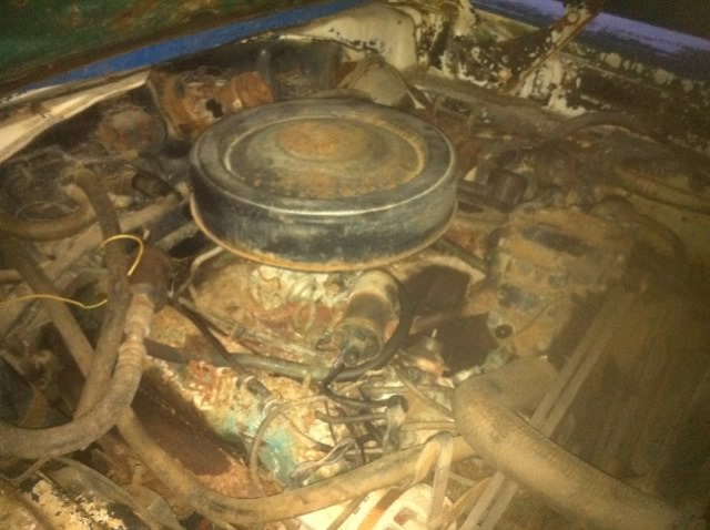

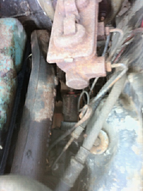

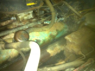

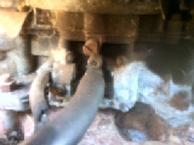

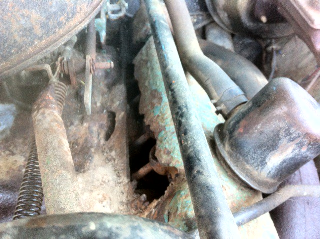

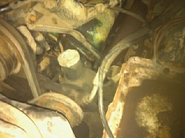

pics, theres a hole blasted in the bracket for the AC unit? also front and back pics of the missing valley pan and the rusted out valve covers, some pics were taken at night

If you can't get it to budge with a breaker bar I would pull the plugs now and start loading up the cylinders with a 50/50 mix of acetone and ATF. If you have some stuck parts in there your going to have to get them unstuck to disassemble anyway and this is a good way to do it. worked for me on a stuck 340 this year.
after seeing those pic's don't try to start it. take it out and put it on a stand. 3/4" rachet set on the crank and pray it moves. mat is right on with lubeing the cyl's even if it does turn. it will make the disassembly a bunch easier. meep is right on the salvage process.
