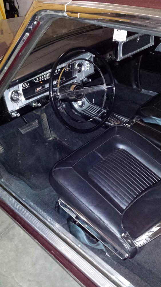

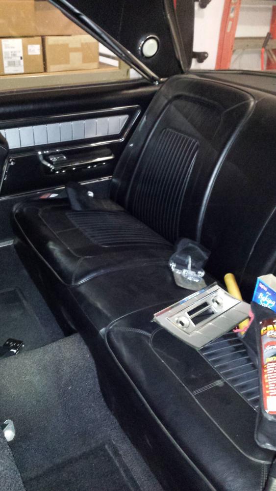

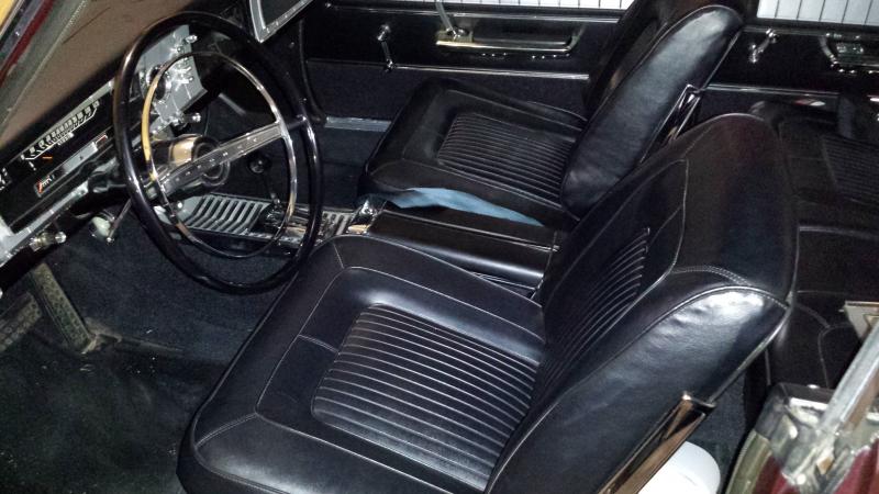

Next fall I will be removing all of my interior (except the headliner) to have frame connectors, torque boxes and mini tubs welded in. My question is....the car currently has a slight case of that old car musty smell but my interior including the carpet is in really good condition. I would like to reuse it all (except maybe the padding under the carpet). I need advice on what steps to take to rid the car of that old car smell or does the old carpet need to go? Thanks for any advice you can give, Al :confused:
View attachment 179307View attachment 179308View attachment 179309
I pull everything out and lightly pressure wash after soaking in laundry soap and drip dry in the sun ... it's personal preference on the smell, fragrance free to las Vegas hooker depending on the brand and I will use windshield washer fluid as a final rince to help things dry faster. The smell of mustyness is mold so it's better to be rid of it. Scotch guard will keep the mold at bay... you will know it when you find it. Same for the seat foams soak and rince till the water is clear then air dry
