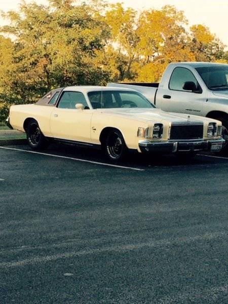

That car looks like a bit of a contradiction. The wheels say "Street Racer" but the vinyl top says I'm a cruiser, NOT a bruiser.
Yeah, new wheels will wake up the looks of the car for sure.

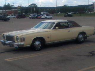

No problem,an thanks for th help.The vinyl will probly go away an i jus got a unused set of original factory caps ( still in bags ) but depending on th mood im in if theyre on or off,i like th look both ways
