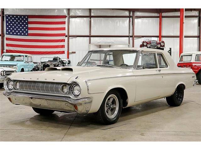

This is about what it will look like. Fawn interior. Has anyone tried M&H street/strip tires? I really like cheater slicks from Towel City but I don’t trust them on the street. The M&Hs look like they have half decent tread but still look vintage enough for me to use them for rears.
What’s appropriate for 64 - 8” wide tire? I think the early steelies only went to 15x6?
A very clean 64 dodge. Think Dave Strickler’s 64 post car without the lettering.
