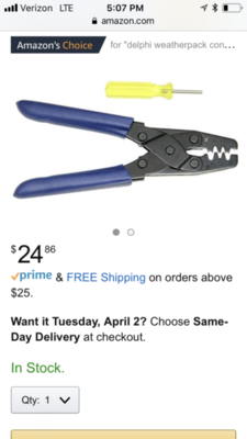

couldyou share where to get the tools to do that job please. thank you

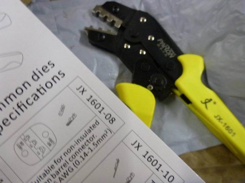

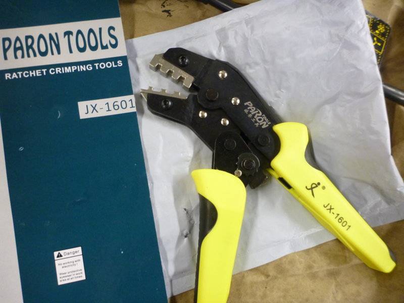

This is the crimp tool:
Thanks Stan, just what I needed another tool! LOL .. $14 US and FREE shipping is a no brainer!
Shipping is slow. I also ordered extra of the crimping dies - they're "cast" so will be the weak point if there is one. They're dirt cheap so what the hell ...
Well the Ebag pictures made it look like you get multiple heads, but you don't! At least it came with the correct head the -08! $14.. FREE shipping.. received in 9 days!! Twice as fast as I get stuff from most States! Just wished I'd had them when I was doing the firewall bulkhead "add lib" with regular crimpers and needle nose..

Did you order extra dies? They appear to be die cast metal and I snapped one crimping one of the brass male bulkhead terminals. I bought a bunch of spares but had to wait on those again. I was givin' the thing hell when it broke so partly my own fault. Also, I thought the ad was pretty clear about only getting one set of dies.
Just their giant leading picture showing 4 sets of dies! No I didn't buy any extras...
