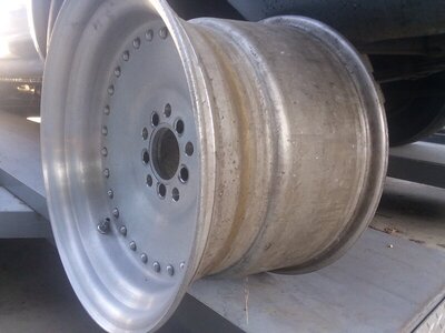

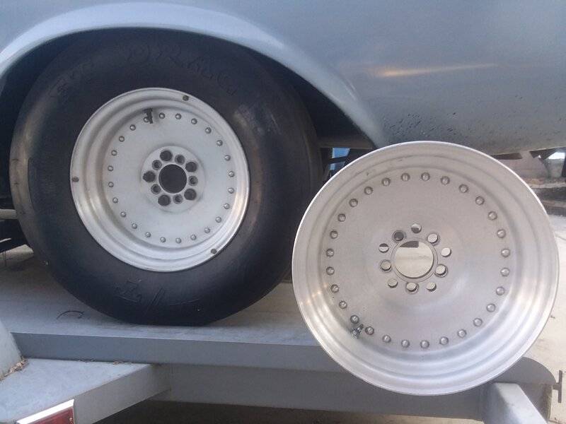

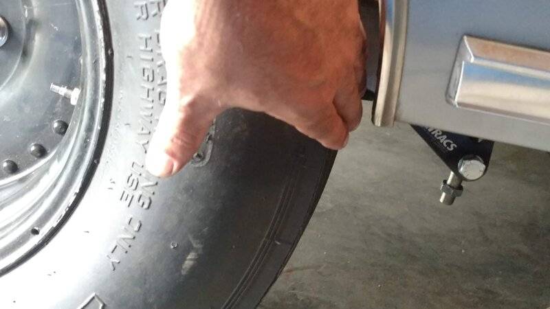

Keep in mind a 10" wheel is actually 11" outside to outside. If those are accurate measurements then you have everything you need to calculate the required back space
That's a lot of BS. Someone mentioned it will be hard to get that onn/off
Yep. Deflate the tire, slide the bottom in under the rearend then try to slip the top in. Might have to loosen bottom shock mount, or even take the springs loose from the rear shackles.7" is the minimum BS that will put your tire 3/4" from the outer fender, but you have more inner room so 7.5" BS would be better. That's a lot of BS. Someone mentioned it will be hard to get that onn/off

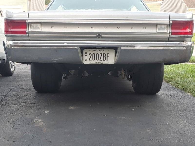

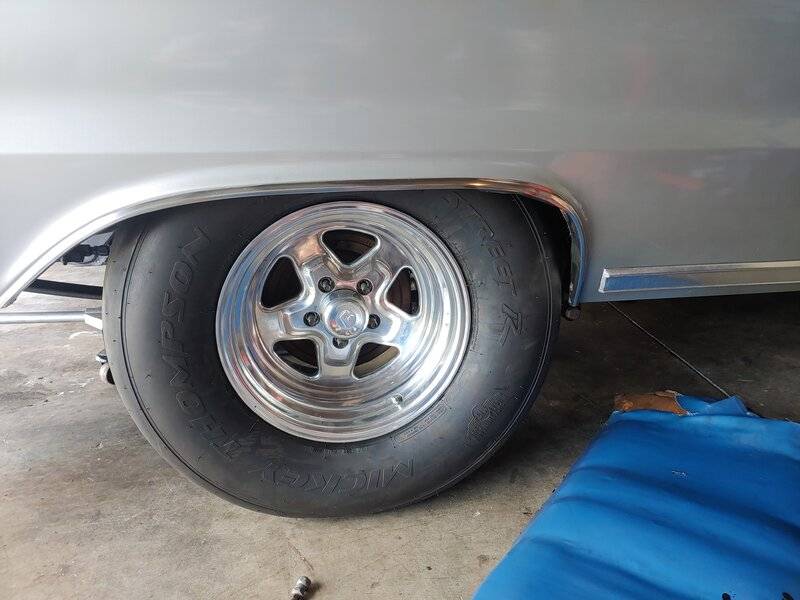

That's a bunch of tire! Looks good. Did you move the axle back?Here's a 315-60-15 on a 10 inch rim with 5.5 bs
View attachment 1149425 View attachment 1149426 View attachment 1149427

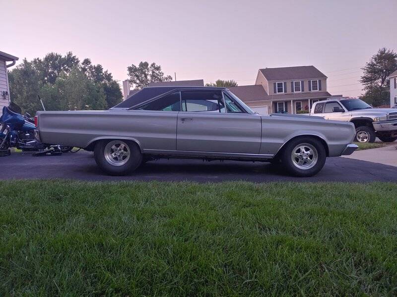

I'll check all of that ...the leaf's are directly under the frame rails so however far apart they are is how far the leaf's are. So, the leaf's are 39" outside to outside and the drums are 60" between mounting surfaces. The 54 1/4" measurement is drum to drum inside backing plate surface. Not wheel mounting surfaces.Yeah, there's something funky with the OP's car if it needs 7.5" BS. I think the rear end has been swapped at some point. The frame rails are roughly 40" outside to outside and he says he has 10" from the rail to the hub face. That makes the rear roughly 60" face to face. The stock rear end is supposed to be only 54-1/4 wide !!!
54 1/4 is flange to flange. 66-67 is 59 1/2 drum to drum.Yeah, there's something funky with the OP's car if it needs 7.5" BS. I think the rear end has been swapped at some point. The frame rails are roughly 40" outside to outside and he says he has 10" from the rail to the hub face. That makes the rear roughly 60" face to face. The stock rear end is supposed to be only 54-1/4 wide !!!
