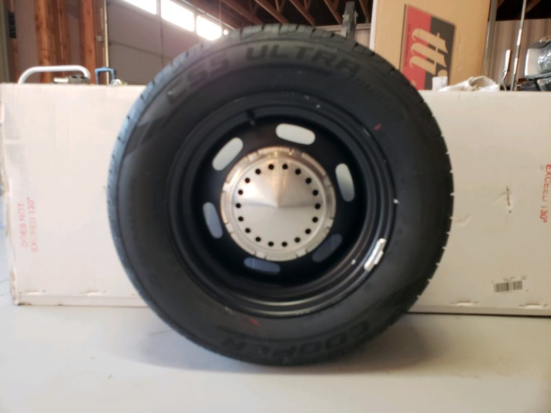

Looking for pictures and advice on 215/70/15 on a 15x7 Police Wheel for a 66 Belvedere II. Seems like a good fit to me. Thoughts?

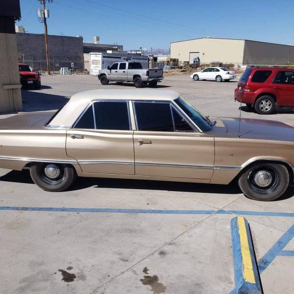

Here's my '67 Coronet w 215/70-15 on steel cop wheels all the way around.
