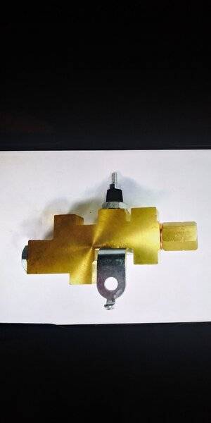

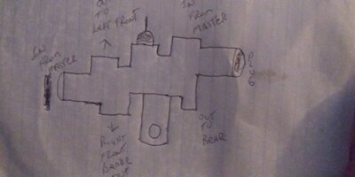

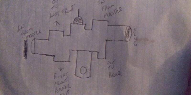

Can anyone give me some ideas on a location to place this valve on my 64 sportfury with a duel master cylinder, power brakes ,front disc\rear drum if possible some pics would really help thanks Nick.

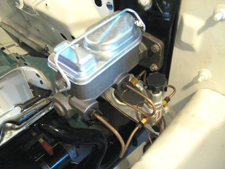

Personally I would just use a adjustable proportioning valve. Most find that even having a adjustable one, it doesn't need adjusting. The dual master cylinder will normally apply front to back all on it's own. JMO

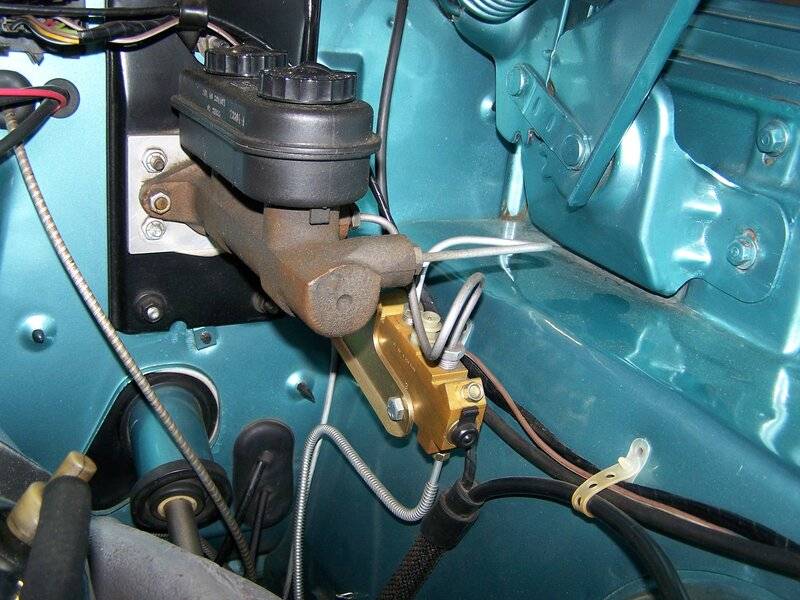

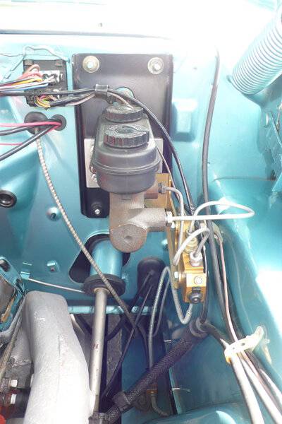

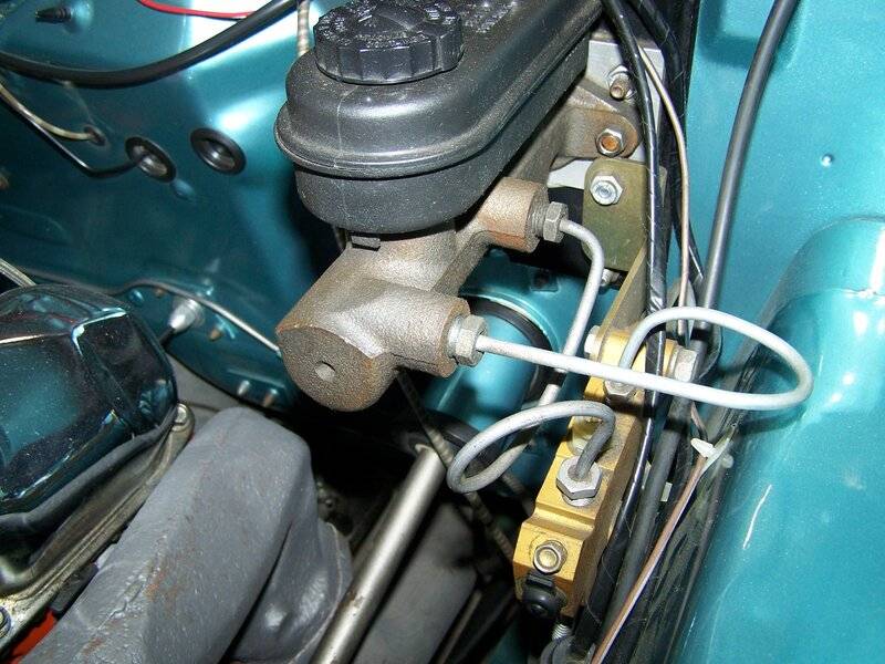

Someone already posted my pic but there's not much to installing an adjustable proportioning valve. On a disk/drum setup you just splice it in the rear brake line. Did mine right next to the master cylinder where it's very easy to get to and adjust.

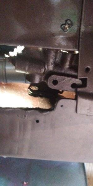

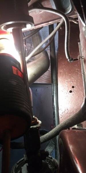

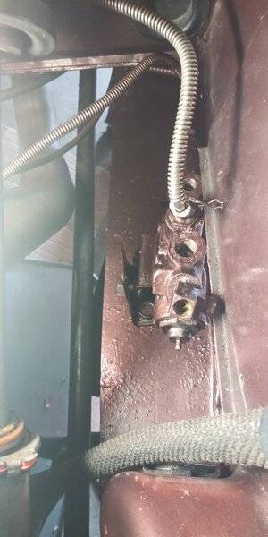

Took this from the car.Would a one piece prop valve look ok it is mounted on the top of frame rail

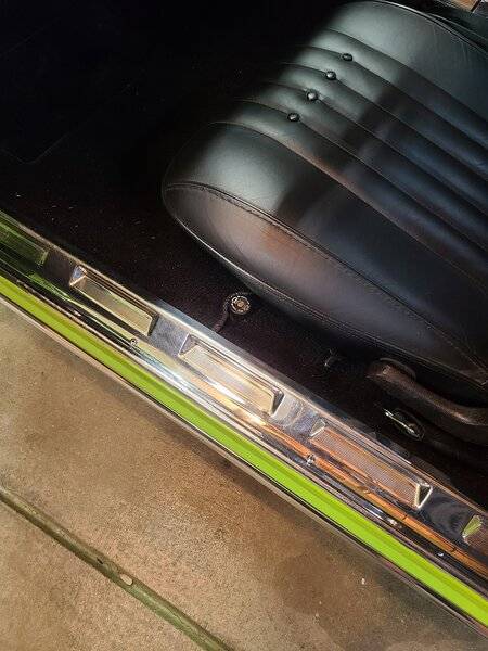

I have the adjustable valve ( wilwood) on my e-body next to the driver seat . Makes it easy to adjust and with the carpet pulled over no one sees it.
