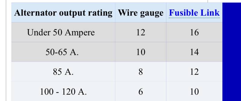

The other factor that you need to be aware of is the wiring you have. It must be able to handle the added load current. Here is a quick reference for you:
Moparfeind makes an excellent point. I wired mine with #8 wire directly to the battery and connected it at the battery with an 80 amp Maxi-Fuse.

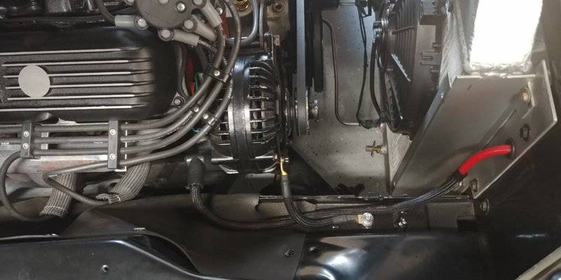

I ran a 4 awg cable from the alternator power lug to the battery and another 4 awg from the alternator case to a ground lug on the frame rail in preparation for an one wire alternator.
The ground cable is to suppose to give the negative AC signal a cleaner path to ground which is suppose to provide a cleaner DC signal and prevent AC whine. I haven't heard any AC whine from the radio since doing the mod, so it must be working. I always crack a smile when I remember back to reusing the old alternator cable as the ground for my fuel pump (the cable was from a modern engine harness kit and I needed a 10 awg cable!). And of course, I completely bypassed the ammeter.
