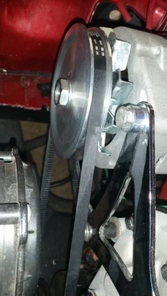

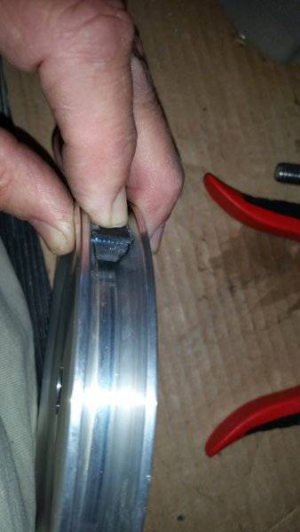

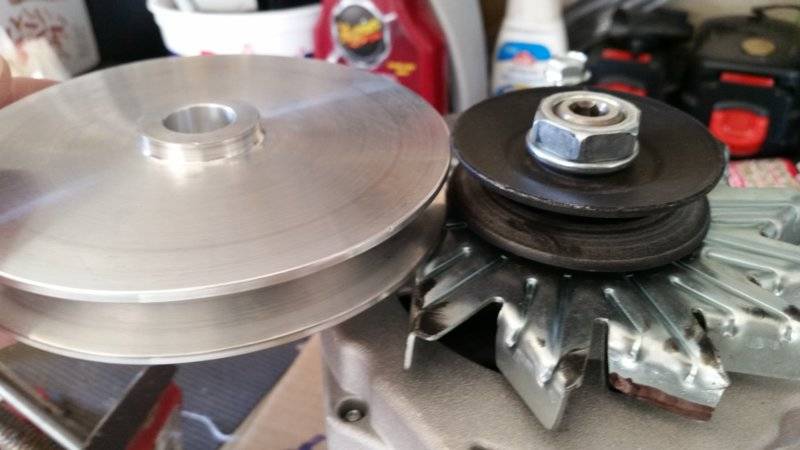

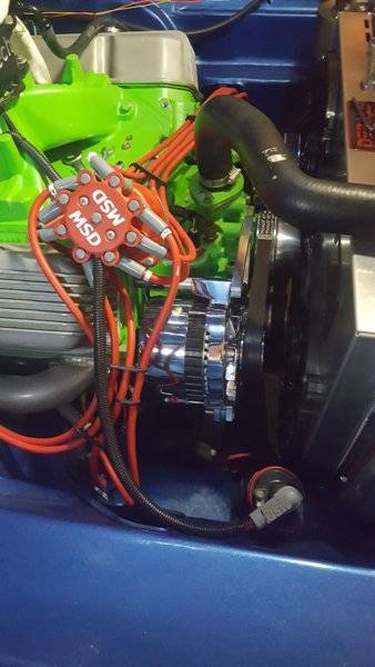

Separate from Alternator choices I bought a 5" pulley from Summit to reduce the HP needed to run the Alternator. The 5" pulley had a much deeper grove also which eliminated any possible belt flipping off. I also ditched the stock steel crank pulley and replaced it with a deeper grove billet pulley.
My volt meter still showed 14 volts at idle.
This setup was on my Coronet that I recently sold.

I was told by East Coast to run th rd alternator at 20,000 rpm. That being said the crank pulley needs to be nearly 3 times the diameter of the alternator pulley.
Doug
wow, I guess I am really old school. I presumed that slowing down the alternator sucked less HP off the motor.
