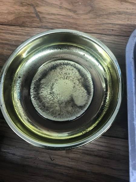

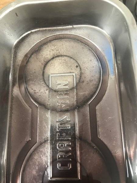

I’d never built an engine before so I bought a book and marked another item off the bucket list. Following the 1st 50 miles with Royal Purple break in oil I removed the filter and drained it and then cut it open. Pored the contents into magnetic trays to see what it was catching. Based on the attached pictures I’m not sure if this is what I should expect or if I’m going to have issues. Thoughts?

Probably machining metal from the machine shop. Bearings are metal but not steel so the crank bearing surfaces aren't magnetic. No chunks just small dust sized particles. Service it and run it another 100 or so miles, pull he filter and examine. If no or very little metal, spin on a new filter and top the oil off for another round.

1) if that was in mine, I would be concerned. But I clean my block after the shop cleans it and I get a pile of metal out and my filters do not look like that.
2) bearings are really your least concern, usually, IMO. It's the cam and lifters. Those are magnetic.

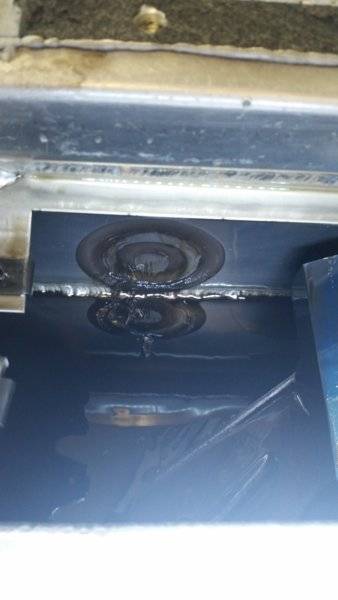

I duct tape a large magnet to the outside of my pan inside the diaper. The pan is aluminum. This is what it looks like after 200 runs. You can see the iron dust stuck at the back wall of the pan.
Doug
ATTACH=full]710506[/ATTACH]
