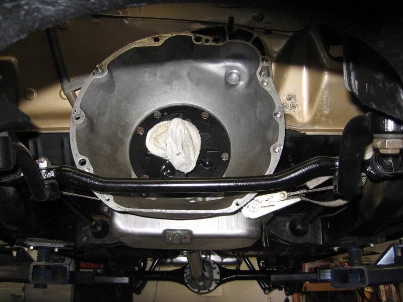

I've done this many dozen times, be sure to push the convertor all the way back in the trans. It will come right out. Just go slow.
I run a ratchet strap under the trans bellhousing that wraps around the torsen bars to hold the transmission in the car.
After unbolting the converter you should be able to push it back to the converter is out of the crank.
The bellhousing dowel pins will want to lift the transmission as you lift the engine.
Usually, I just pry them apart the lazy way, but it make re-installing more difficult.
You could loosen / remove the trans tail shaft mount bolts to get the transmission to move back a bit.

Use a small C-clamp to hold the converter in. Place it through the opening in the bottom against the converter. The ratchet strap is a good idea. Leave the mechanism accessible so you can tighten it. A floor jack under the trans until you get it out will help. Trans lines tend to get in the way, I'd pull them off. Cover the trans outlets or it will continue to drip. If the trans has a drain plug drain it now.
Doug
dvw & Darter have good suggestions. The cooler lines will likely be in the way, take them out. Use something to hold the convertor in place, I've used a short piece of wood, gently wedged into the ring gear to hold it. I also have used a floor jack to raise the trans up into the tunnel to gain a bit more clearance for the motor mounts. it just takes a little wiggling to get the angle right for the motor mounts to clear.

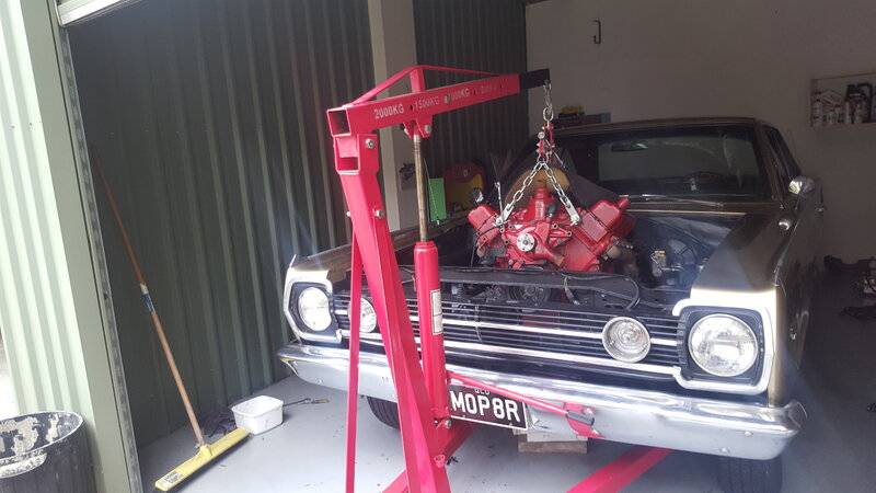

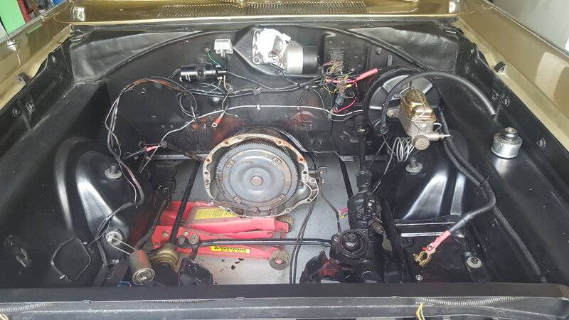

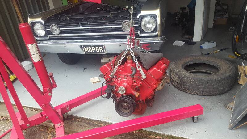

Engine popped right out this morning. Came apart from the transmission so easily, especially once I remembered to remove the last bolt (after 10 mins of cussing and trying to pry them apart haha).
As the engine was coming up the front end was lifting too with the weight coming off the suspension - it sits up like a gasser now.
