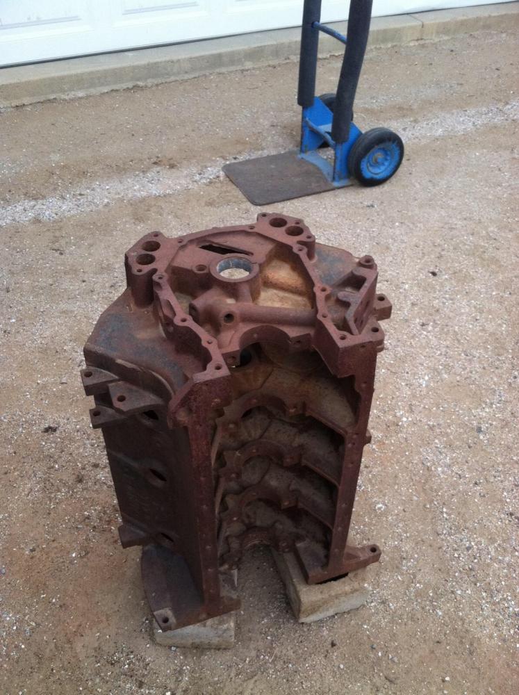

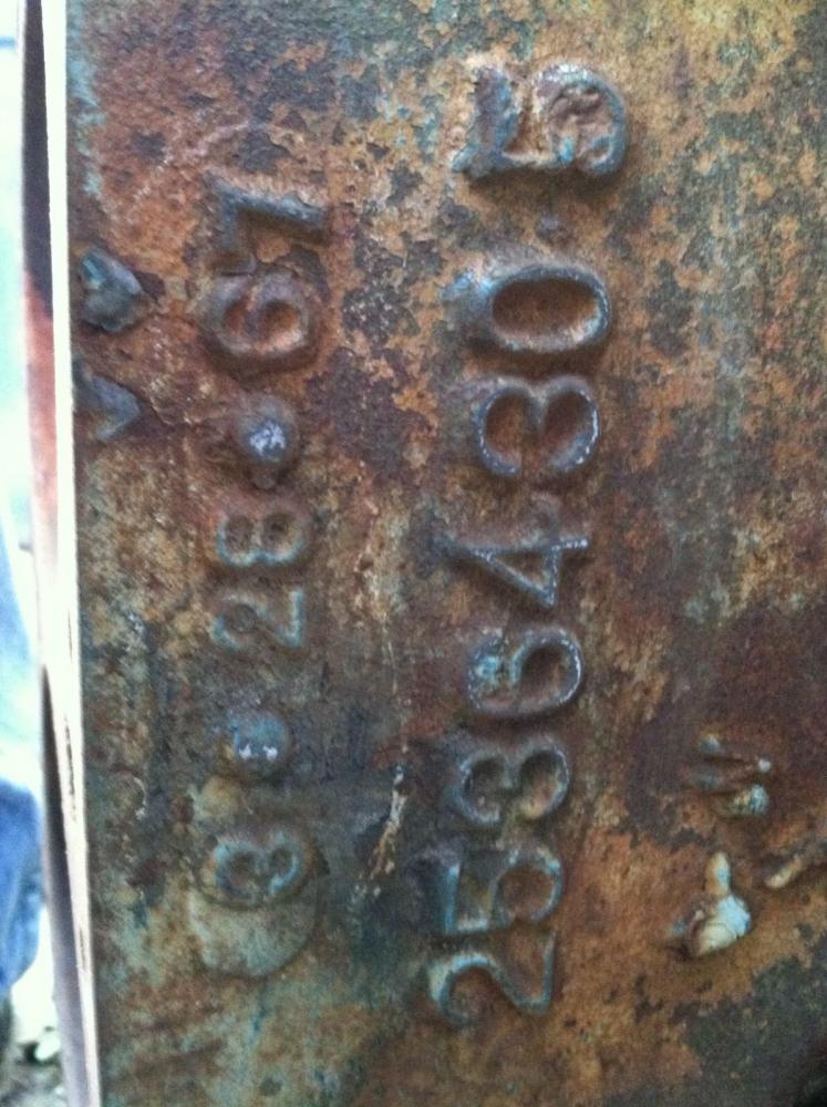

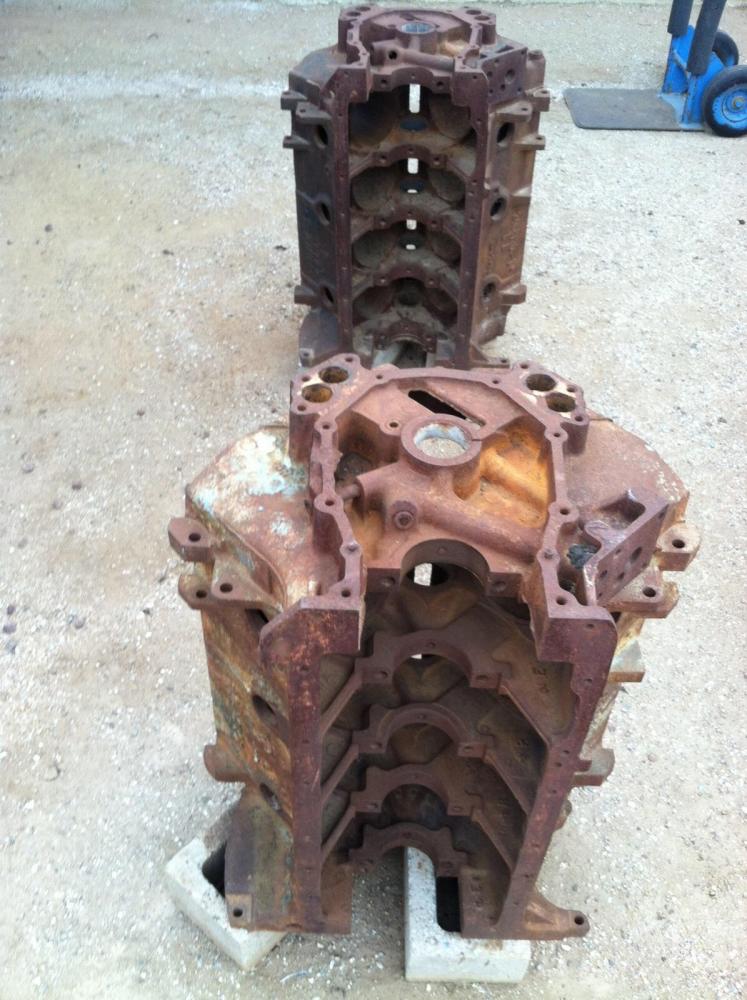

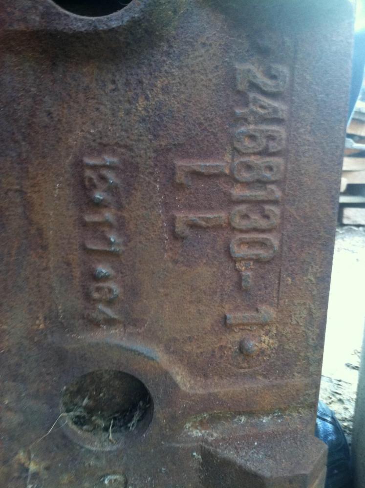

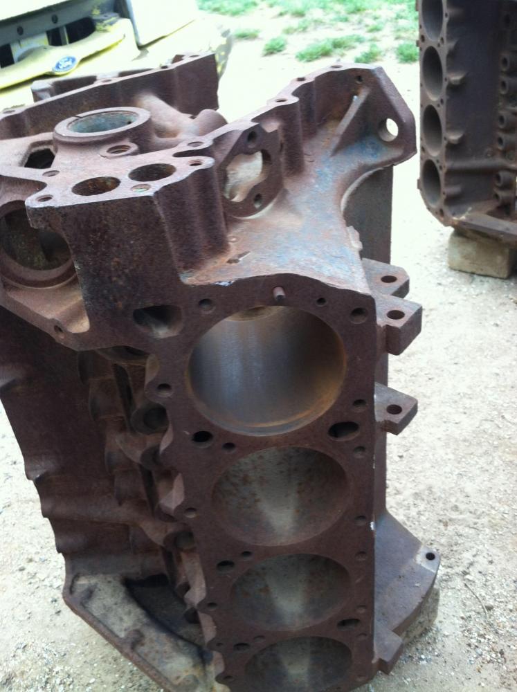

440 and 383 pics
Here are some more pics of the 383 and 440. Let me know what you guys think. Can I work with these.
Thank you

Looks too rusty, and doesn't have the main caps. Even if he has them, the mating surface is rusted up. As was said before, buy as complete an engine as possible. you will need all the accessories, and hardware otherwise, you will be hunting down every one of the missing items. Also, a cast crank is fine. I've had a cast crank 440 in my car for 14 years with no issues. Motor home engines will need everything changed. they are only good for the short block.
Furyous is spot on. That deep rust is an issue not only for the machined surfaces but inside the oil passages too. Those fine rust particles will most likely get washed off the surface over time. If it was a numbers project I'd be saving it with muriatic acid, but in your case find another block.
