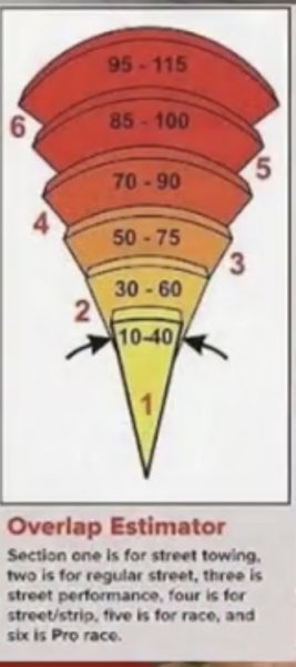

Below a quick chart from David Vizards book on the overlap estimate you should be looking at.

I am an admirer of DVs work but I think he did a disservice publishing that overlap chart because it is based on advertised duration, not 050 duration. 050 duration of course is...050 duration. But adv duration can be anywhere from .000" to 0.008" tappet lift. That variation can amount to a substantial amount. He doesn't specify at what tappet lift those numbers were generated.
The numbers in his SBC book vary slightly from the chart in post #16. 10-35 v 10-40. 90-115 v 95-115.
Haha... I'm going to go out on a limb here and say that nobody on this planet would select a cam based on LSA alone! My overlap numbers are from the .050 like the desk dyno does when you enter the specs.
Using advertised duration numbers, the Howards cam is 71 degrees, "4" on DV's chart. Hughes only uses an .050 and doesn't even give an advertised duration... but it's basically the same.
