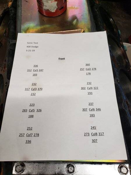

400-470, built in 2019. Less than 1000 miles on it. Sonic check results in attached picture. Only a mild ~500ish hp build with ~10:1 compression.

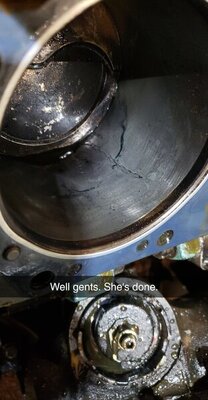

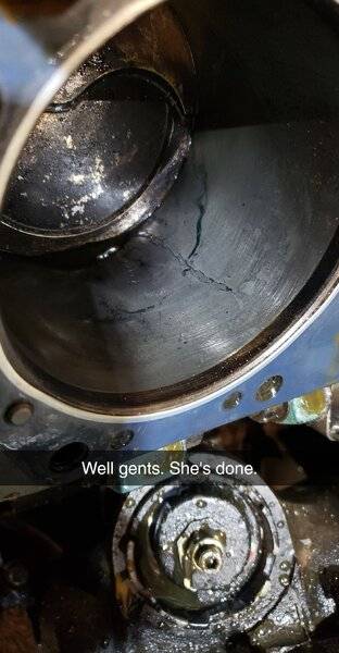

I found water in my oil and after taking the heads off I found a cracked cylinder wall on cylinder 1. I took the engine out and found another crack on cylinder 4.
Now it needs at least 2 sleeves and after looking at the sonic check results closer a few other cylinders have me nervous... what would you do? Spend the time and money finding a new block or spend the money on sleeves and run it?

Was the sonic test before or after it was bored? If before, how much came out? Not all sonic testers can show interior pits on the inside. That said, just putting 2 (or more) sleeves in might solve the problem for those two, but sleeves are an interference fit, and WILL impinge on any adjacent cylinder requiring honing of those cylinders also. In my shop, sleeving will run about $110-$120 depending on the cost of the sleeve, then boring & honing to size as I am sure it is not currently std. Getting another block will require sourcing block, cleaning, sonic check, align hone, squaring, boring, and honing all over again. Sleeving the current block might cost less, but how might the other cylinders be; just like the two that already cracked?

It looks like its cut too thin!! The other 6 cylinders cant be much different. Just a matter of time before they all crack. Weakest link will break. Something's not right. I would re-evaluate the whole engine and probably build something a little less volatile with whatever I could salvage from that.
You are missing about 2/3 of your sonic test measurements but the ones you do have, if correct, are very good. Something else is wrong. The block shouldn't split with those thicknesses.

Looking at the sheet, the thin areas are not on the thrust surface. Where were the cylinders measured? Top, middle, bottom? Or are these numbers the thinnest areas? #1 in the sheet shows that area to be between .183"-.312". If the measurements given were the thinnest spots I'm surprised it's cracked.
My 400 blocks compared really close to most of the 440 blocks we tested. The numbers on the chart look pretty good. The crack shown is not like anything I would expect.

Checked before boring and was bored to .035 over. Soundsike we have very similar concerns about the other cylinders.
I'm very curious as to what "something else" may be as it barely got used and wasn't really beat on at all... I'm frustrated and confused as to what caused this.
Great question and I should have asked the machinist more about it when I had it done. He was confident that it was solid and there would be no issues since he could offset bore it to compensate for a couple of the cylinders.
Have you seen anything similar? Short of a thin cylinder wall, I'm not sure what causes this. The car is stored indoors with thermostat at 55-60 year round. Car is barely driven lately due to a 2 year old and life...
I would love to see a sonic test done all around your crack. That would tell you a lot more info about a possible why.
