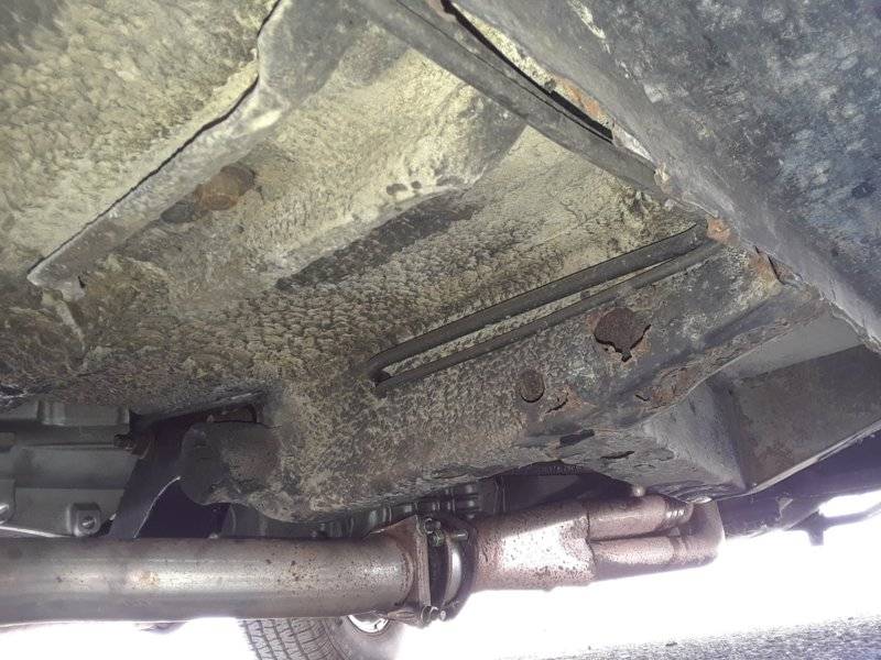

No opinion on price, but the picture here should make you look closer.
In my opinion (since you asked)The potential crossmember rust you see is coming from the inside and could be compromising the torsion bar boxes. The amount of underbody coating hides a lot, but a quick poke with a screwdriver along that member will tell the tale. Rot there is a bunch of work to fix correctly IMO. Not to mention it appears someone does not know how to jack up their car.
Surprised to see no trunk pics, especially the drop-downs and every inch of the rear sheetmetal from underneath. A lot of tell-tale signs of hidden rot can be had there.

The upgraded drivetrin is a plus. I am still concerned about the rust. If the cross member is like that, chances are there is more somewhere. Get eyes on it for sure.

pretty sure that's what a can of worms looks like right before you open it up.........way too much undercoat, rotted crossmember, how do you adjust the alignment with that goofy bolt thingy? I bet the entire *** end of that car is a mess, which is typical for 68-70s...... I'm thinking bondo buggy at least, total rot box at worst
Imho, I'd keep looking for something better/less work needed. Bet there's a lot more rot you can't see. I just finished rebuilding a similar car without as much rot as that and I say forget that one unless you want to do a lot of work.... And it looks like that car had no front sway bar and one was added along with the weak aluminum brackets on the lca's.
