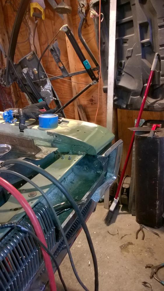

Well, i fooled around with the front grille today. I learned alot. What a PITA. I've come to the conclusion that I need to wait until i have the case mounts in place so i can determine the correct location of the center grille and turn signals. I did figure out that i had to swap sides on the lower cross brace pieces to allow room for the cases to spin. On the Coronet the two ends with the raised sections are where the headlights mount. Turned around they are correct to mount the grille center, ...i hope. This car has been hit at least once in the front end. If i could afford it i would get an entire new front clip. It was lined up good when i got it so it will line up again.

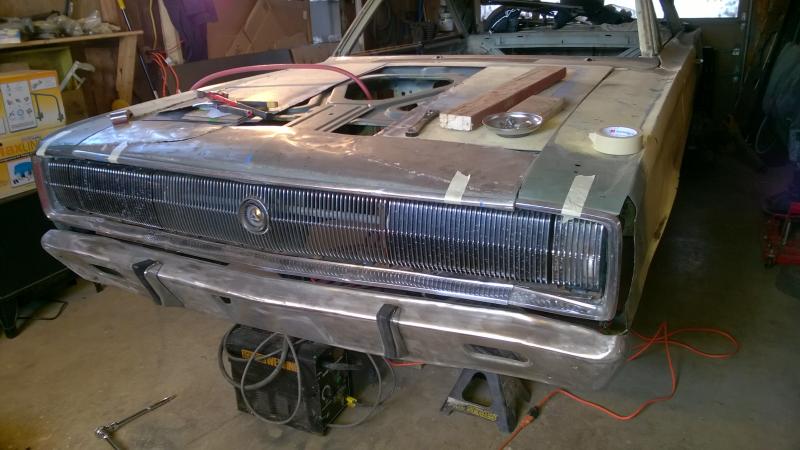

So. Here's the mock up trial fit of the header panel. Did this for a couple of reasons, one, the shorter hood length weighs less to flip forwards, two, the hood front lip will never be out of line with the fenders, three, I can now use the trunk hinges, or some like them, to flip the hood forwards and the 1 inch front edge will clear the header back edge no sweat. Before I had to have expensive double scissor type hinges to lift and clear the grille and the space between the grille and the radiator under the hood where the bottom surface of the hood drops down into that space just in front of the upper radiator support rail. So, all in all I think it's a win win. Plus nobody has to see that space.

I got the lower cross braces a couple of days ago and mounted them on the car today. worked out perfectly. I reassembled all of the brackets and bolted them up too. I then cut my axle to go from case to case and hammered a 4 inch long piece of CVPC tubing into each end of the axle bar. This tubing is the exact size to slide into the case ends. The whole thing is together now and rotating quite smoothly. Only things left on the mock up are the window motor/frame and two flanges too bolt to the case ends that will have a pilot hole cross drilled through them and the axle for alignment pins to go into. I have not yet decided which way to make the axle turn. It will either be a driven gear fastened to the axle or a window lift cable pull/pull arrangement. Anyway, it's together and spaced correctly for now and I just need to adjust here and there to get the fins spaced right. Here's a video link...

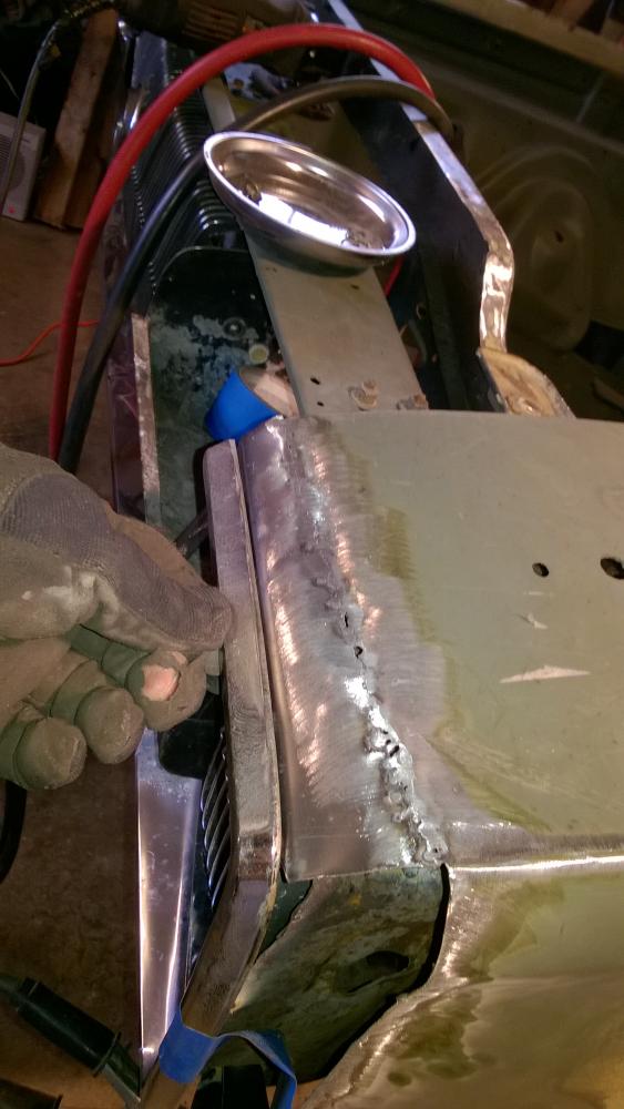

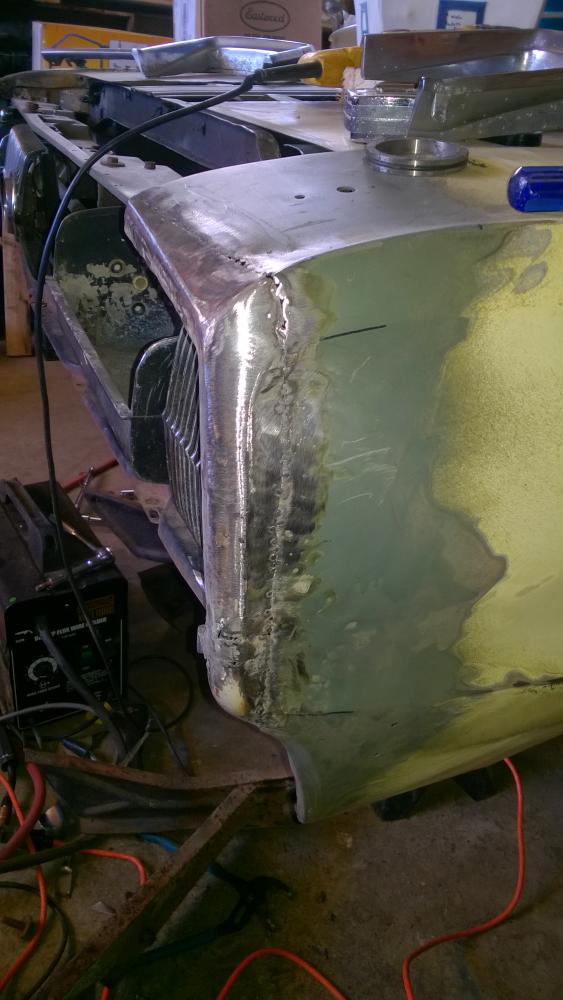

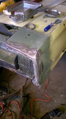

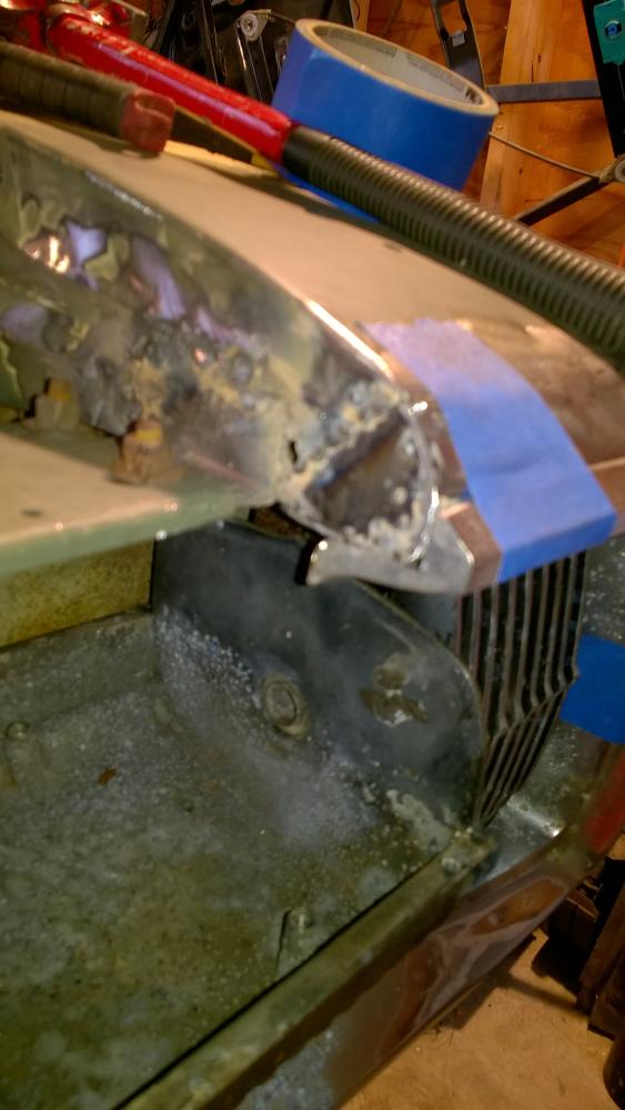

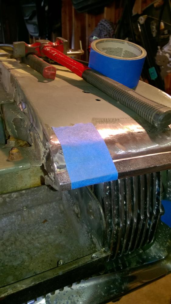

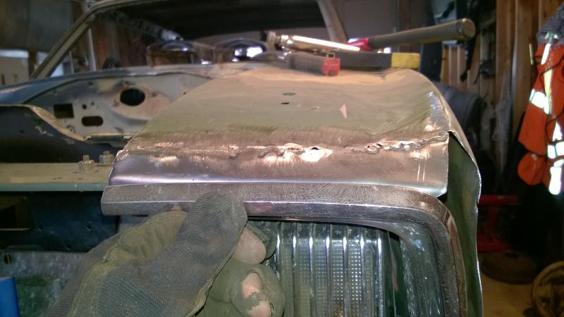

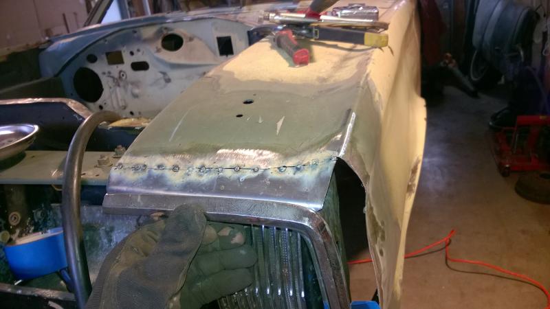

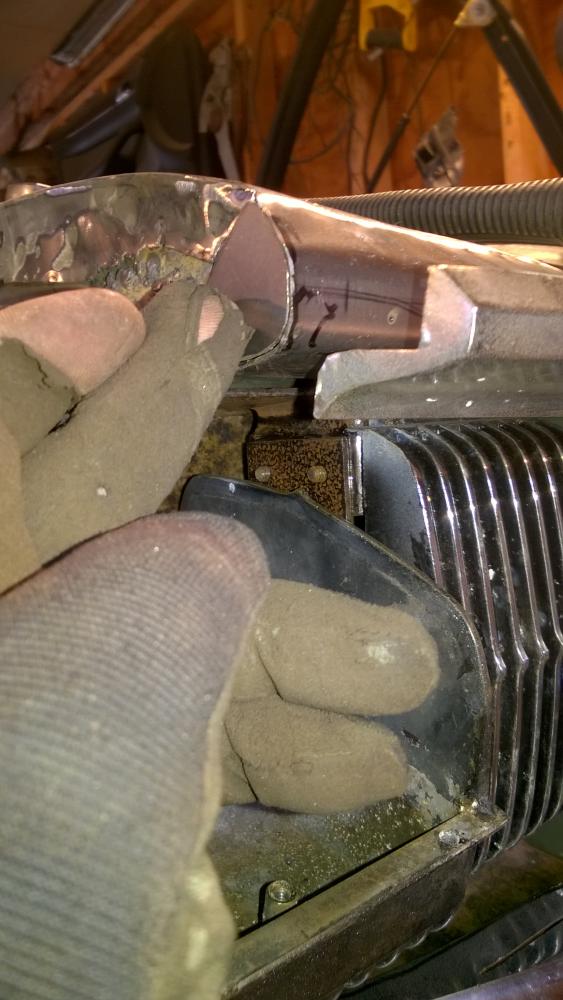

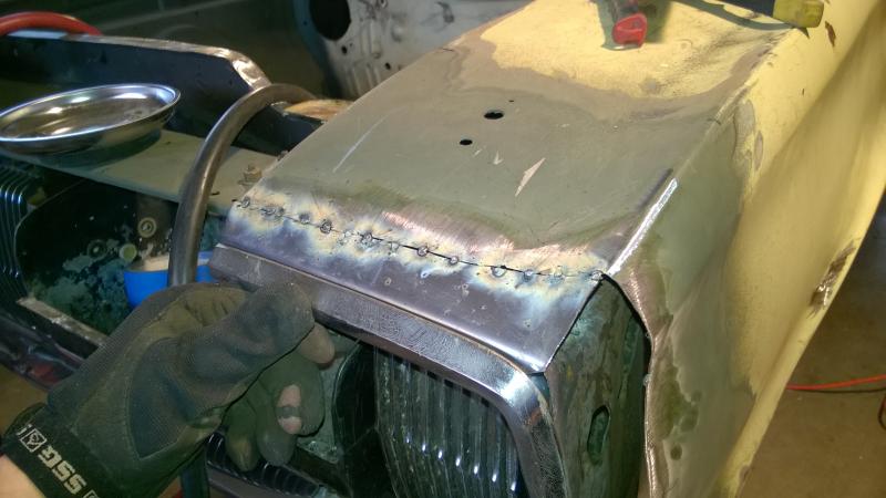

I decided that the left fender nose was too damaged to leave on the car, even after cutting most of it away. So, I cut it off made a steel guide conforming to the slopes and angles of the right nose and fabbed a piece to go in there. I also noticed that the left fender top was sitting way too high up, I guess I was on drugs that day or something. So I sliced it free and pulled it down. I measured from the bottom of the other fender to floor and put the left side at that height. I also measured from the radiator support to the inside bottom edge and transferred that also. So now they are the same. The piece I made worked out great and now I just need a small portion of a stock fender nose for the contour lines and front flange where the "C" chrome mounts up.

I managed to cut out the hunk I needed for the left front fender from the section that YY1 sent me, and it went in fairly well. Now both sides look identical.

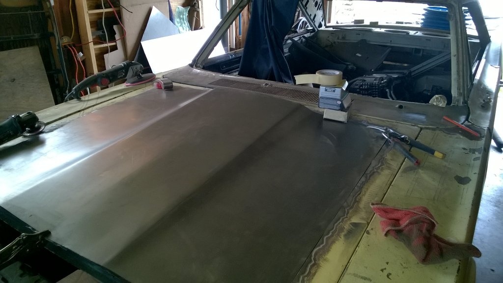

EXPRESS UPDATE....I finally got back into the swing of things and did some work on the ole' girl. After much consideration I have decided to scrap the dual scoops and instead fabricate a Road Runner type center bulge. I have it about 85 % bent how I want it and am now cutting away the stock hood skin. I like it, plus it get's rid of those slanted contour lines from the hood surface. What say you?
