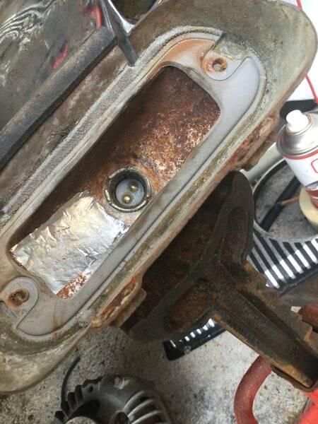

Have a picture of the socket?

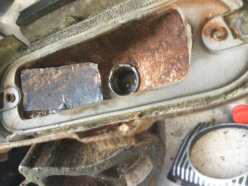

Here’s a pic of the socket. Despite the rust on the unit the actual bulb holder is clean and apparently ok
03C8CC46-25FB-41A0-BD47-666E137426CD.jpeg D5AF27FA-F504-4CE4-AFB4-85299B248660.jpeg
You can look into the socket and see the offset grooves for the bulb pins. Make sure the one closest to the base goes in first and into the deepest groove. If it doesn't go in one way, try the other way. It has to be a double filament bulb for park and turn lights.

When the bulb is pressed down into the socket it should depress on the spring so it can be twisted for the pins to slot into place, the twisting also aligns the metal contacts with each other. If it doesn't depress far enough perhaps there's rust built up under the spring tab underneath..not allowing it to depress far enough. check.

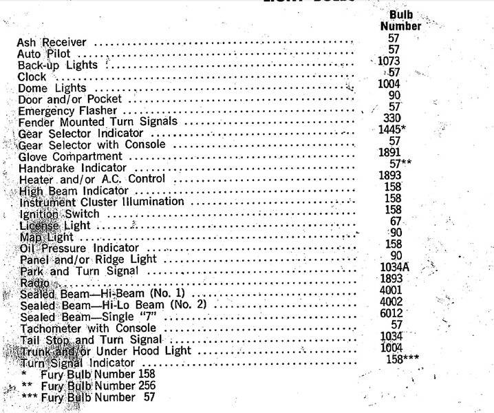

This is from my '66 Plymouth FSM. Probably the same for Dodge, but not sure.
Also found this...
Primary Filament Operation at 12.8 Volts
The primary filament is used for normal marker-lamp (the rear light that comes on when you turn on your headlights) operation. The 1157 lamp can sustain 2.10 amps at 12.8 volts, and will last an average of 1,200 hours. The 1034 lamp can handle 1.80 amps at this voltage, and will last an average of 200 hours.
Secondary Filament Operation at 14 Volts
The secondary filament is used for turn signal operations. The 1157 lamp can sustain 590 milliamps of electrical current at 14 volts, and lasts an average of 3,000 hours. The 1034 lamp lasts an average of 5,000 hours under these conditions.
Considerations When Choosing Which to Install
Since both lamps are used as combination turn-signal and marker lamps, choose the lamp that suits your needs best. If you do a lot of daytime driving and require a long-lasting signal lamp, install the 1034 lamp. If you do a lot of nighttime driving, and do not need to use your turn signals often, choose the 1157 lamp.
Yep, so the Milesdodge original 1034As should work.
