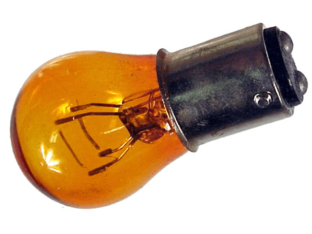

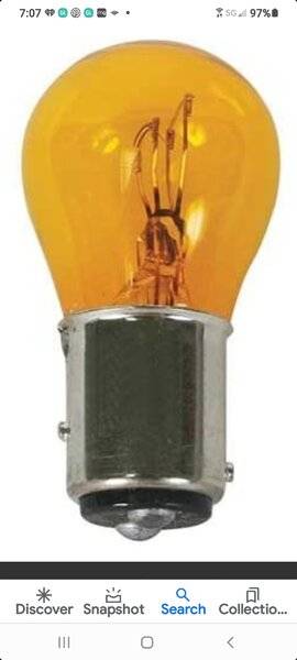

Dual filament bulb, #1157.
1 filament for lights on (steady) the other filament for turn signal (flashes brighter).
If the lens is clear, the bulb should be Amber colored, if the lens is Amber, a clear bulb will do.
Ok. Then the 1157 in Amber.
It twsts in, directionally about a quarter turn. The connections on bottom will line up when you push and turn in correctly (the base of the socket is spring loaded).
1157 was the original number from back in the day.
Later cars progressed to a #2057 and so on.
There's different numbers for intensity and bulb sizes, but as long as the base (with staggered tits) fits in, and the lens covers the bulb, you're good to go.
If the socket is old you may need to wiggle the bulb a bit for a good connection, or, replace the socket.
Good luck.

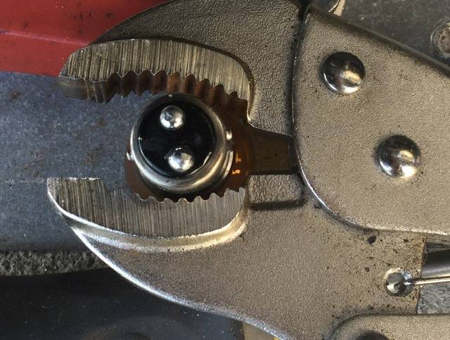

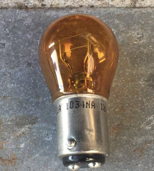

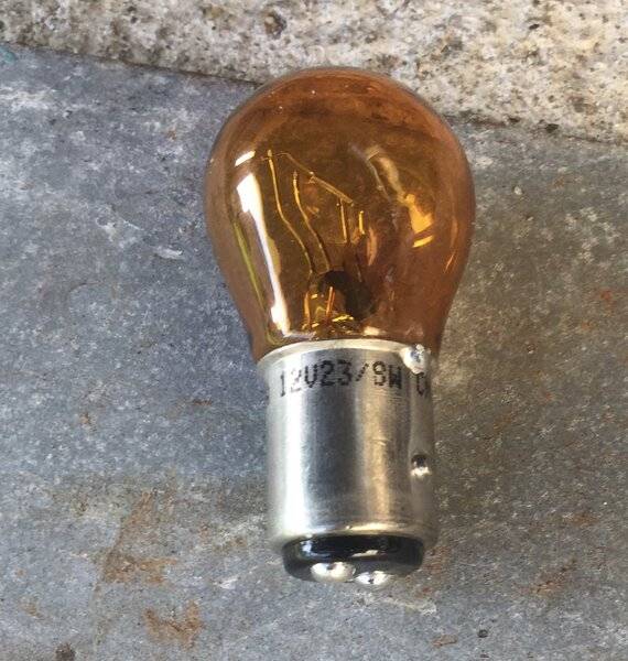

I’ve enclosed 3 pics of the bulb sent by Roackauto. I cannot get it in the socket. The socket itself moves cleanly, the plunger works well, but the socket for the bulb looks like it has two offset cut aways for the bulb pins. My bulb/s don’t have that,
E06360A4-4B51-49E4-917E-CB35281361C1.jpeg D42966C2-2A62-4870-840F-22AF045E27FA.jpeg
Part numbers are for a reason. If it calls for 1157, why use a 1034? May be a slight difference in pin spacing or orientation, even if they look the same. 1157 used to be the most common small bulb used in car tail lights and park lights. Are they not available any more?
I only ordered the bulb as it was listed as correct by Roackauto, over here in the UK there’s a lot of stuff we can’t get. I just tried to find an 1157 bulb as suggested, the only option is for an LED version which does have the offset prongs/pins I suspect I need. Never had this issue with bulbs before on other Mopars. Live and learn I guess, in addition can’t even buy a simple main sealed beam unit over here...all unavailable.
If they wont go in far enough to turn and lock it can be eased by filing a bit off of the two metal tits/contacts on the bottom. This will allow it to sink in farther so you can turn it to lock in place. Alternately, check the bottom of the socket for debris, a little grease on the sides and contacts, dielectric grease, will also help.
