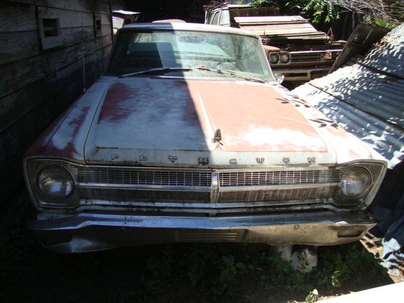

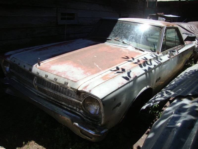

It’s a 65 satellite with 426 emblem on the hood ,426 street wedge ,,,I’m just trying to see if a 426 wedge should have 518 casting number heads or did they come with 516 headsyes it could have been ordered in . can you get the build sheet ? and is it a satellite commando car ? i have a 65 sat commando 383 4psd car with a/c ps . so you got what you bought back then i guess . View attachment 588856 View attachment 588857

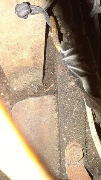

What bottom end was used if its stamped A 426 hp?was it a max wedge bottom end with the same compression?The ID tag on the drivers front of the block should say A426 HP and a date it was assembled. the casting numbers on the drivers side of the block between the heads and the oil pan should be #2532230. The last 3 casting numbers on the heads are 516 and they have small valves and don't flow for crap. They used the same heads on all of the "B" & "RB" engines that year, meaning even the 361 two barrel used these heads. I have one of these cars and have restored 5 other ones, so I'm pretty familiar with them. By the way they are not really very fast in stock form, but they can be made to fly with a few changes.An engine is just an air pump, so you have to get more fuel into it and then be able to get it back out. These engines really respond to an aluminum high rise intake, a better cam, headers or Max Wedge exhaust manifolds and either aluminum heads or a pair of the Chrysler 1967 closed chamber 915 iron heads with bigger valves and port work. It should have a big chrome unrestricted air cleaner without any snorkels on it and also chrome valve covers on it

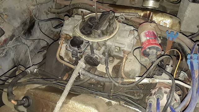

In the engine pictures this motor it has the wrong intake, carburetor and valve covers. It should have a low plane iron intake with a single feed carter afb carburetor and the chrome valve covers were smooth and had a push in chrome pcv cap and the push in chrome oil cap should say oil on the top of it. The ID pad stamping appears to be correct for the 426 street wedge motor.
And some real “shade tree” plumbing done on that engine. VC’s could be real rusty chrome also.In the engine pictures this motor it has the wrong intake, carburetor and valve covers. It should have a low plane iron intake with a single feed carter afb carburetor and the chrome valve covers were smooth and had a push in chrome pcv cap and the push in chrome oil cap should say oil on the top of it. The ID pad stamping appears to be correct for the 426 street wedge motor.
