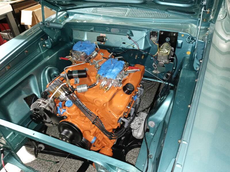

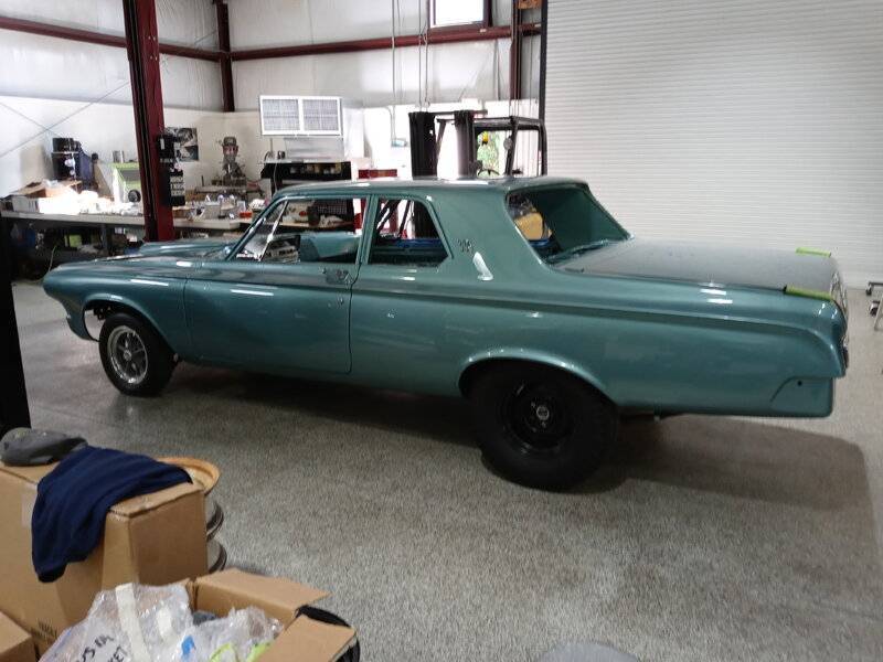

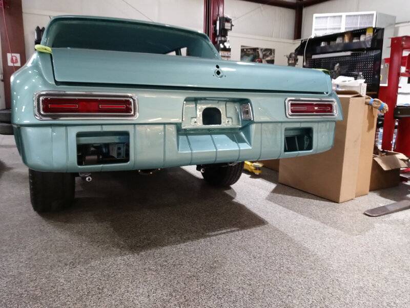

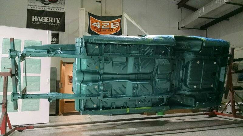

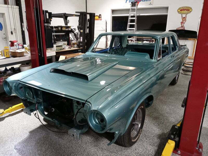

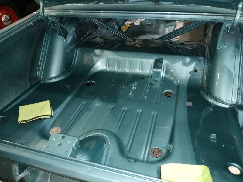

I've been meaning to do a build thread, but never really get around to it. I'm not really a computer guy, and just use it to fill in the voids. With our winters, I have a bunch of down time around now. Here's a few more...
Looks like US Car Tool subframe ties. Makes for a factory look install and very strong.

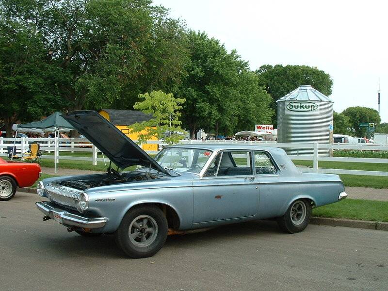

looking awesome love 63 dodge 330s and love the color have had few real ones over the years also some clones the blue one hc stick car 509 act miles the the red one first factory lt wt built was grey from the factory

Nothing says " Race me. I dare you. " like a '63 Dodge. Those thrusting headlights are so aggressive. I ended up with '64 Dodges, but missed out on a couple of '63 coupes along the way. Regret it.
Right you are! Love the 64's myself. Keeping a eye open.
