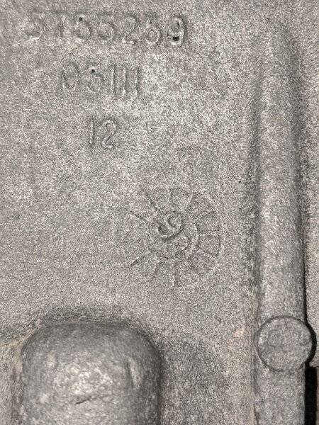

Can you get better pictures of the casting date circle and the stamp under the part number stamp?

Best I can get.
I think there number is more like 307? Not sure if it's a 3 though for sure.
The circle date seems like 68 backward. Maybe it says 98?
Much better!
307 - 30th week of 67, 77, 87?
Cast burst looks like 86 to me?
Those two don’t add up for me for 67. The cast date should be 67 to match the stamp of its the 30th week of 67. Either way, I’m not seeing this as original to the car. Part number for the starter is (edit - NOT) fine but date codes don’t work IMO.
Maybe someone else will chime in. Find one with dates from the late 60’s (confirmed) and see what they look like to compare.
I take that back about the part number. Looks like that part number was introduced in 75. Looks like a replacement starter from the 80’s.

86 to me also and some 4XXXXXX part numbers also bet it is a rebuild.
