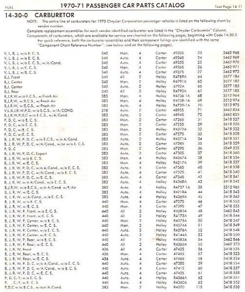

I have a 70 RR, 383 auto, with AC. When I got it it had a Holley on it and I’m pretty sure it’s a 650cfm. I’m looking to replace it but not sure that’s what came on it from factory. Anybody know for sure.

My carbs list number is 4166, other number on air horn is 2708. Carb number on build sheet is 62.

My build sheet says Carb 62. So according to the parts book it originally came on a 440? My original engine is a 383, “RM23N0G”. Am I reading the parts sheet wrong?
All sources say 4166 was used on 1967-1969 440 not a 383. a lot of info is in the FSM. Have you looked at yours ?
Is the build sheet for your car, a dumb question.
Yes. You are reading it incorrectly. That number is a reference to another section of the parts book with additional information on that specific carb. It is not a reference to the BS code.
Code 62 = Holley 4369 = just as 33IMP posted in #6.
