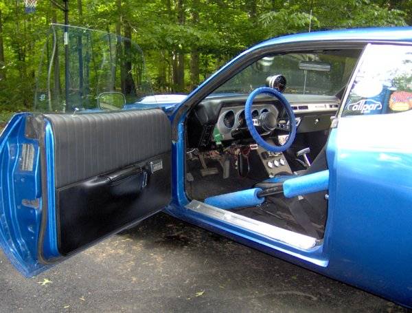

I assumed that would be the case, but you never know. I recall what those little ring retainers look like but if not there where can they be purchased? I assume that the original backing is behind the new upholstery as you said. Also I assume the rubber block under the door glass is bolted down?! You can see my door panel below. Thanks again.
The block is secured with a flat tab that pulls down through the lower door shell, should be able to see the tab on the bottom of the door.
