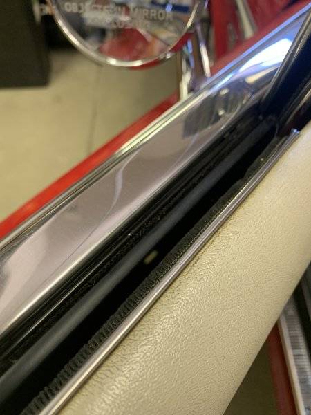

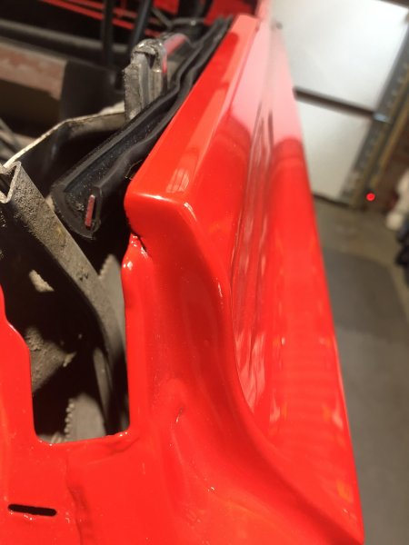

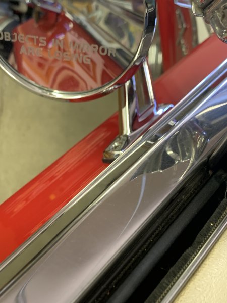

Question for My B Body experts.... Getting ready to install Window felts on the doors and quarter window on a 64 convertible.... don't want to mess it up.

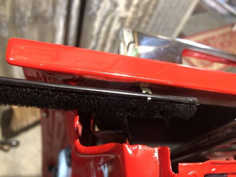

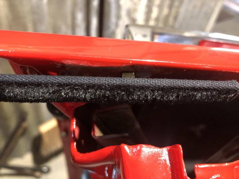

1- On the outer front doors, I believe the fabric side goes up, and the Black metal goes down. These are Top Cat Fuzzies. Is That correct ? one pic shows fabric up, and the other has black metal up...they have white paint dots on the black metal ro help line up with the holes also. I would assume that would not be up.(and seen)

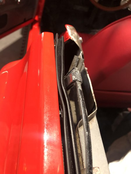

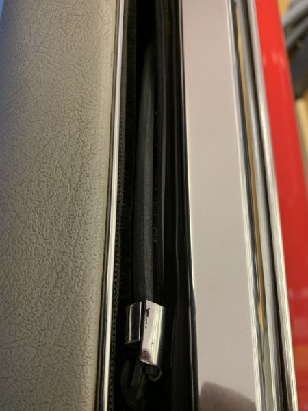

2- On the quarter windows, Does the V channel face up? it looks like it should, and I found some photos online and it appears that way ??
here are some photo's to illustrate my question...

Howdy, On my 63 Fury convertible I installed the quarters with the V up. On the door outers, I installed with the metal up. That's the way they were from the factory as I don't believe they were ever changed before I got the car...
