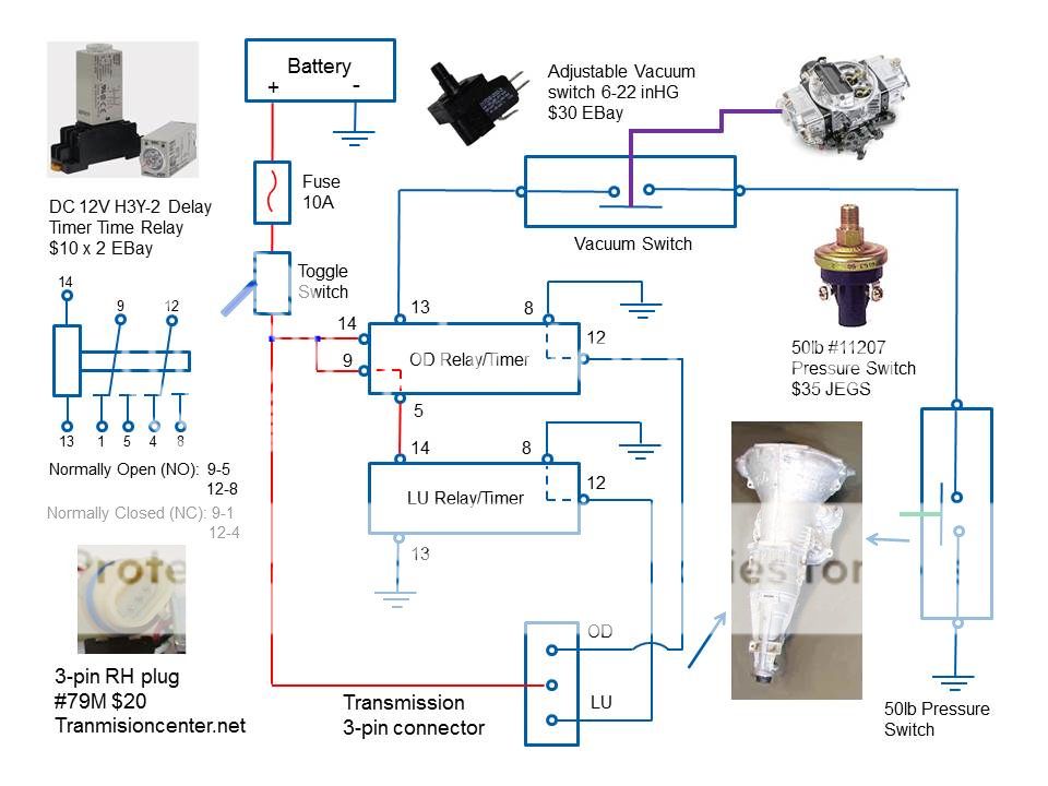

I am using a 1994 518 with JW Performance bell housing adaptor behind a 440. The OD and lockup is each controlled with a electric solenoid that can be controlled manually or automated using pressure switches. Not cheap by the time you buy a stall/lockup and the adaptor but the OD/lockup is great.

I thought the RH trans was hydraulic control with the OD being electric and could be turned off an on with just a simple switch?
The A518 46RH is hydraulic an can be switched on with the parts I showed above. The A518 46RE is electronic and needs a $700-800 controller to make it work.
The simple parts above will cost me about €250,-...

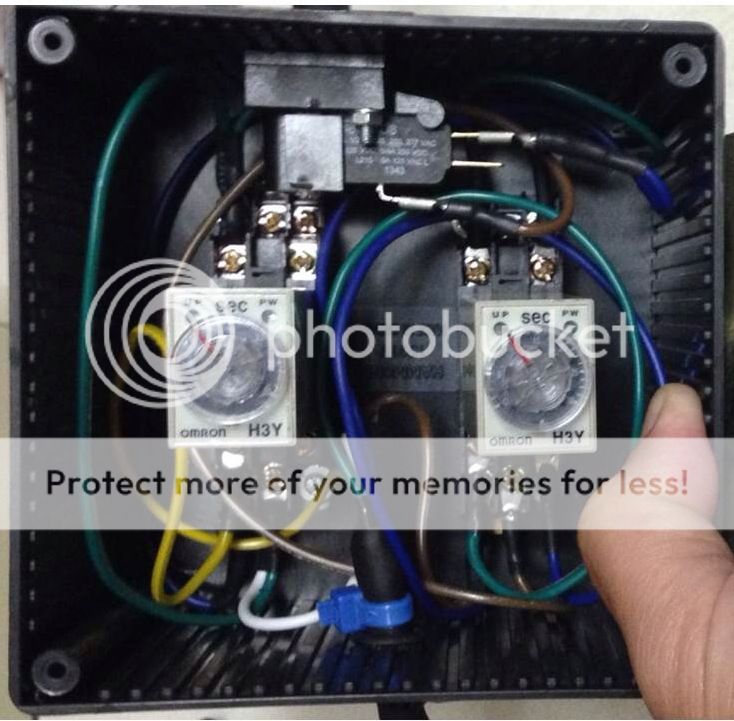

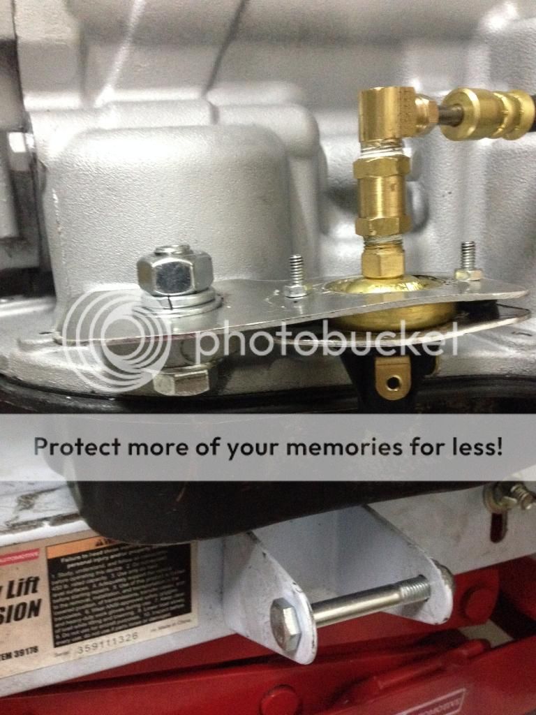

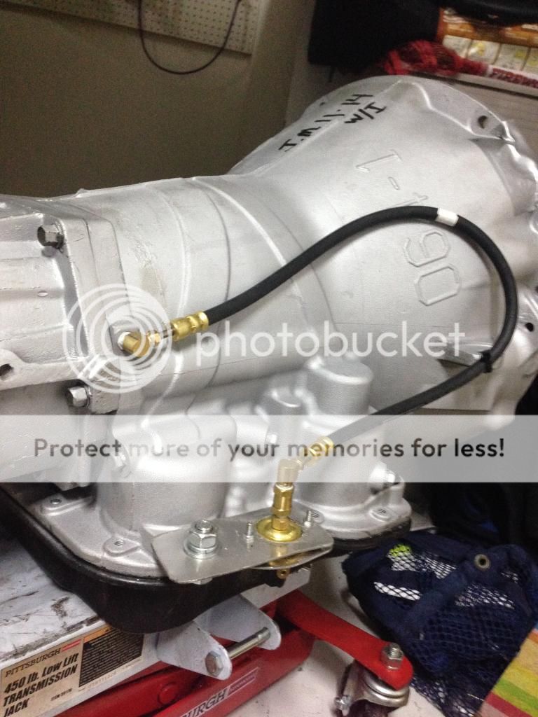

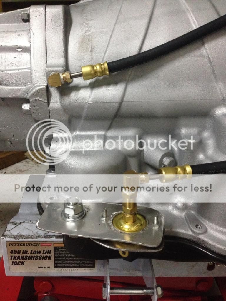

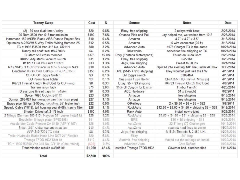

Here's a partslist of someone that used it for his own build:
and instal pictures:
He used this setup for his small block challenger so he didn't had to chop the bellhousing and replace it with a JW Performance Ultrabell bellhousing...
