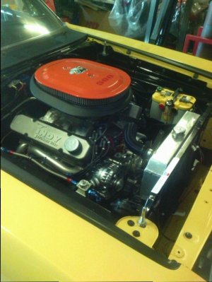

same here. 28x19 griffin crossflow, 2- 1 1/4 tubes, core fits 22" opening on a 68 form S , .mech. fan on 1/2" spacer, alum home made shroud, 15" elec fan mounted off rad. in front far as I could get it, set to come on at 200, hasn`t come on. 505" should be about the same h.p. as urs. see if u can blow up my avatar.
