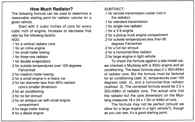

Here is something I ran across might help to see where you stand.
