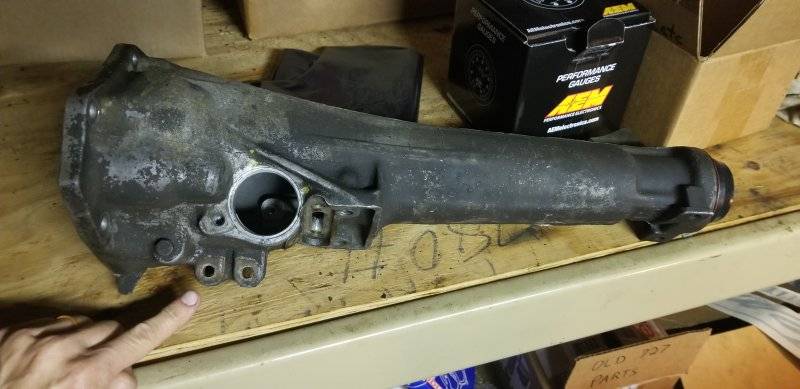

I'm not talking about the shift or kickdown linkage linkage that goes into the valve body.
The Slap Stik floor shifter has a bracket that bolts to the tailshaft as shown in the picture below (just below where the speedometer connects). A 518 transmission doesn't have this.
Now I'm not trying to say this is an insurmountable problem, but the stock Slap Stik will not work with a 518. I've never modified one to work with the 518, so I don't know if that is an easy problem to solve or not.
I wasn’t aware of that lack of bracket. Thanks
