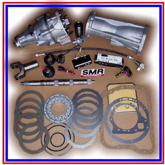

SMR 727 'Shortie' O/D kit,
like $3015 added to price of trans selected IIRC
(or self install)
you can get the kit separately too
don't remember the actual costs $3115 (?)
(gear venders O/D unit & SMR adapter etc. IIRC)

SMR Trans "Shortie Overdrive" 727tf w/OD
http://smrtrans.tripod.com/smrtransmissionsintro/id32.html
but they ain't cheap, but little to no mods
obviously need to do a driveshaft shortening
some require a dent in the floor to clear the speedo adapter etc.
check it/them out

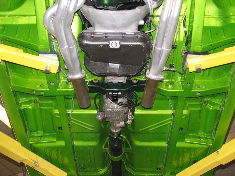

this is a stock photo from them in a Dart
