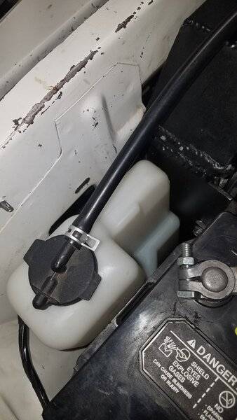

Where do you mount the Toyota overflow tank? I have a small stainless mounted to the radiator, barely fits, and it is obviously too small a capacity. I just don't really see any real-estate under the hood of my '67 Coronet.
Snuggles in between the battery tray and core support. It just kinda wedges in there, never needed any permanent attaching means. Not for the factory resto builds but works excellent on my driven street car..
Thanks, I'll check the space n see if it will work there for me. I want to be able to daily drive with a closed cooling system.
