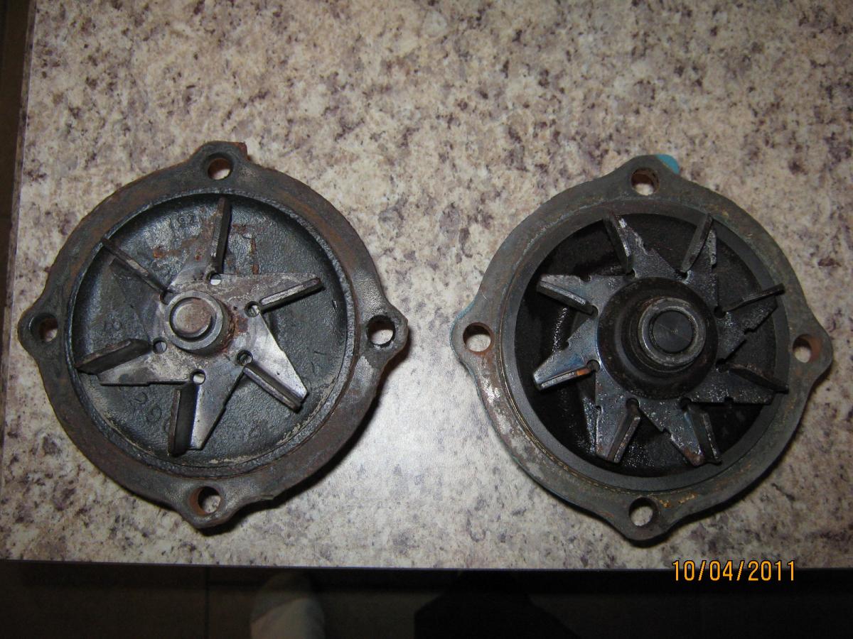

Alright I have a 65 coronet wagon. It originally had a 361 BB engine in it with 65,000 original miles when i bought it. I got it running with the original engine, did a tune up, valve job, head gaskets, hoses, belts, water pump,thermostat, cleaned the radiator and so on. Drove it around quite a bit last summer even towed it to the mopar nats and drove it to the show with no overheating issues whatsoever. Then last year in late September I was going to drive it about 1 hour to a local mopar show. While going down the interstate it got hot on me. The best way I can describe how and when the car would get hot is if you ran it at 2000 rpms or above. Under that it was drivable and would stay cool. If you ran it hard or kept the RPM up it would overheat rather quick. So the engine was using quite a bit of oil and was smoking , so I had a rebuilt 383 short block laying around. So needless to say I used it and a fresh set of 915 heads for a new engine for the wagon. The only 2 items that are the same from the cooling system are the radiator and the water pump that was new when I first got it running. Well after 7 min. of run time at around 2000 RPM with the new engine installed it was getting toward the Hot mark so I had to shut it down. Seems to be the same issue as I was having before? So I pulled the new thermostat and tested it on the stove and all seems to be well there. I also pulled the new water pump, and noticed that besides the impeller having more blades it is the opposite direction to an original water pump that I had laying around. I will post a picture of the back of both water pumps. Both are facing up in the same manner. The one on the right is the new one and the left is the original. I hate to be so long winded, but i just can't figure it out. I have also removed the radiator for another trip to the radiator shop. Please let me know what you think. Matt

The 6 blade pump is for a/c and max cooling,the blade configuration is not relevant,still does the same thing.The six blade pump circulates water slower and keeps in the radiator longer for better cooling..
If it is doing the same overheating on two different engines I would have to say your radiator is the problem.

Good luck ..... i just solved my overheating issue .. had the same water pump as you ( the right one ) ... replaced with a mancini aluminum high flow and housing .... flushed the radiator out .... what a difference ... on a 90 degree day am now running at 175-180 ...
Do you think it had more to do with the flushing out of the radiator or the change to the Aluminium water pump and housing?
Thanks, Matt
If the problem was on two different engines your problem lies in the radiator! not the water pump and housing.

i know the problem was in the radiator, was not holding enough fluid. flushed it out 2 times, now holds 2 gallons ..... when i took the water pump off to inspect the impeller, saw that big void behind the fins ... decided to go ahead and upgrade to an all aluminum, high flow setup .... and for $160 i thinks its well worth it !
