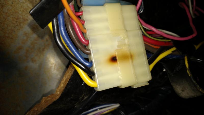

Hi Guys
While replacing instrument cluster bulbs I noticed a connector which seems to be over heating. Anyone come across this and have advice?
Thanks
Here is a picture. I started the car and it does get quite warm to the touch. RR-wire.jpg

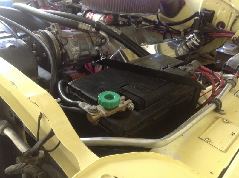

I will definitely get a fire extinguisher. I love these old cars, but you never know. Where do you put the battery cutoff?
What do you recommend to clean the contacts? I probably wont tackle this till the weather warms up. I usume you unplug the connector, but then does this type of connector allow you to push the wire through to clean and then pull back through? I want to disrupt things as little as possible under there if you know what I mean?
image.jpg Battery cut out. Marine grade from West Marine. Wish it was in the cabin.

Once you make the repair you should also squirt some dielectric grease in the connector ends.
I don't have my wiring diagrams in front of me - check what that wire feeds. Are you pulling a lot more power in your system now than originally? If so, you might replace all this only to have it happen again. Make sure that is the source of the problem, not the result of the problem...

You are having a high current draw on that wire. The connector may or may not be the problem. Just fixing the connector may not solve the issue. Trace the wire and find what it feeds. Check all related components and connections.
It would be a good time to go through and clean up your bulkhead connectors.
That looks like it might be the iginition harness to me. like others have said, make sure to trace the wire. Do you still have the original altmeter in you car? If so that could be a problem. I has to replace the whole dash harness due to fire because of this very issue with the ingition and altmeter. Still haven't gotten it back in yet though.

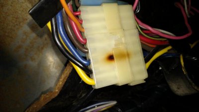

Hi Guys
Thanks
Here is a picture. I started the car and it does get quite warm to the touch.View attachment 243702
If that is on a 74 as your user name suggests and it is a blue wire with a white tracer then it feeds fuse cavity one.
Fuse cavity one has a 20 amp fuse and protects the following:
Interlock control unit
Ignition run feed
Brake warning lamp
Power window safety relay
Heated rear window relay
Trunk lid release solenoid
Voltage limiter(standard cluster)
Oil pressure indicator lamp
Temperature gauge (standard cluster)
Fuel gauge
Thanks for all of your posts. It's been cold here in the northeast so haven't been in the garage much lately. As soon as it warms up a bit I'll get back out there. I did buy the Ox-Gard and plan on cleaning the connectors and applying the Ox-Gard. Will also try to trace the wire as you suggested. I did have an issue with the drivers side headlight burning out and did a clean and retighten of the ground in that area and so far so good. Know sure if that was the issue or not as this was done before I noticed the burned wire.
