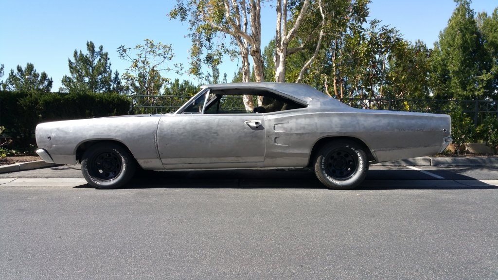

I stripped my '68 Coronet by myself, down to metal, over the course of a couple months. You just need a good angle grinder, DA sander, and lots of patience. You can do it. And a decent place to do it. I stapled plastic from ceiling to floor in my garage, to protect the "man-cave" area, and it didn't matter. I got paint dust EVERYWHERE.

It was kind of satisfying, and strangely therapeutic to have done it myself.

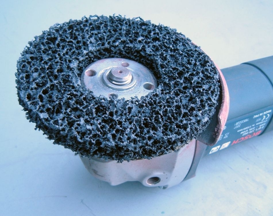

My 66 had several coats of paint and after spending a couple of hours on it with a disc sander, a buddy said to try razor blading it. I laughed but it worked!! Once the majority of paint was off, I DA'ed it down to bare metal with ease.
I've heard of people using razor blades with good success. I just can't imagine doing an entire car with it. These stripper wheels worked great.

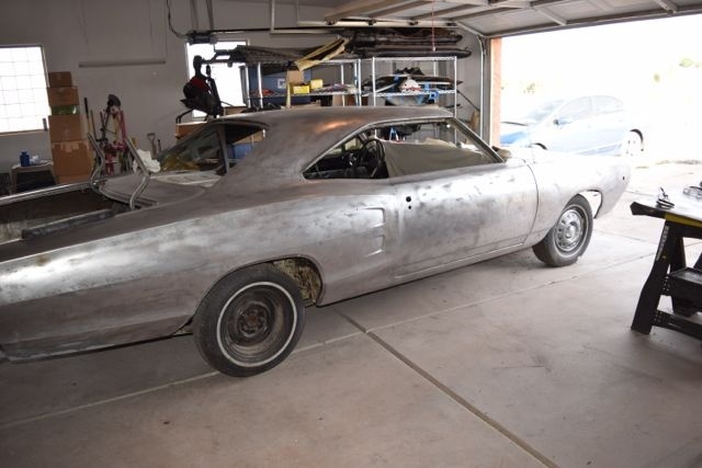

Must be in the air! I stripped my 500 over the last 2 months too! I used aircraft stripper, nasty stuff but no dust. Now that I am block standing primer that dust is getting EVERYWHERE….

Tell me about it. I've been doing body filler/block sanding, but I have to move the car outside to do it. My garage is a tandem, so not a lot of room to move around. Yours looks pretty rust free, as mine was. Be happy you have a "normal" garage. I'm kind of enjoying the body work, strangely. I'm sure I'll feel differently after 100+ hours.

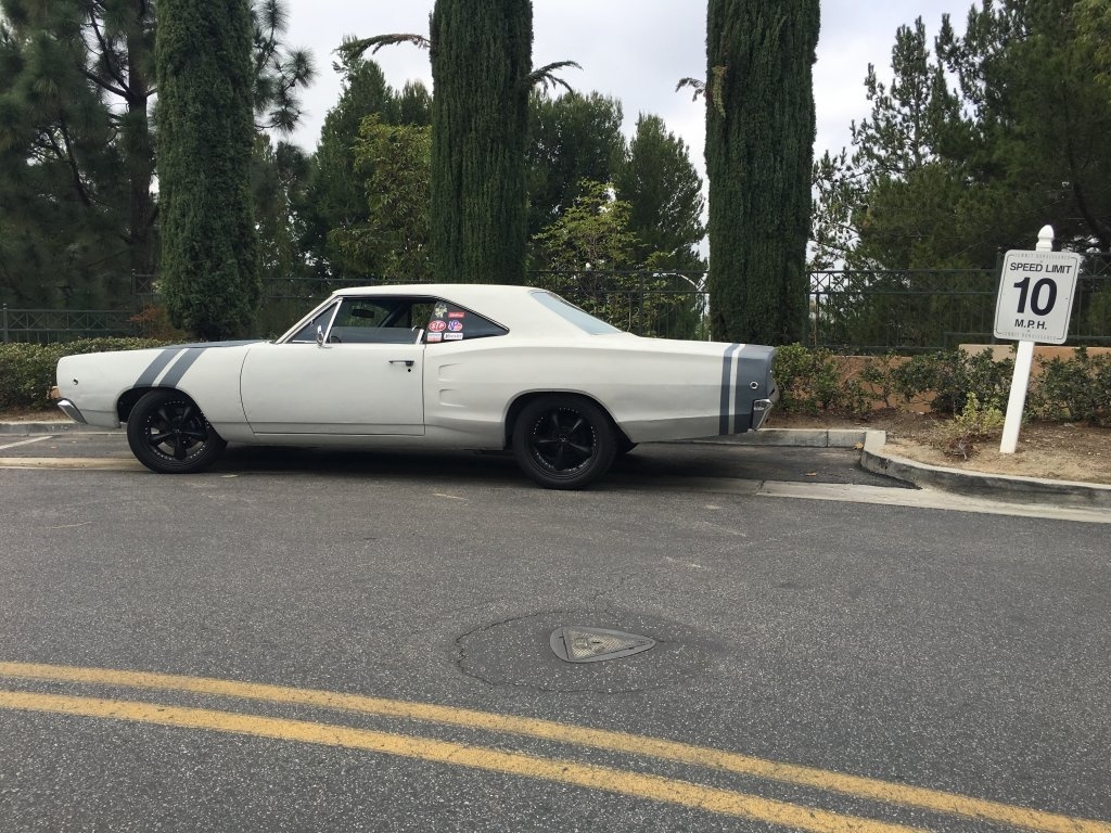

What size tires are on your car? I like that look.

I changed to modern style wheels. Here's how it looks currently, just had some fun with different colored primers.
