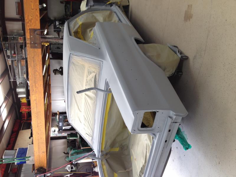

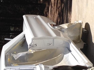

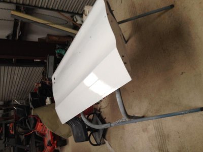

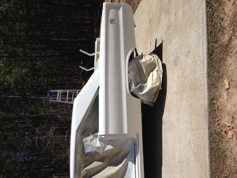

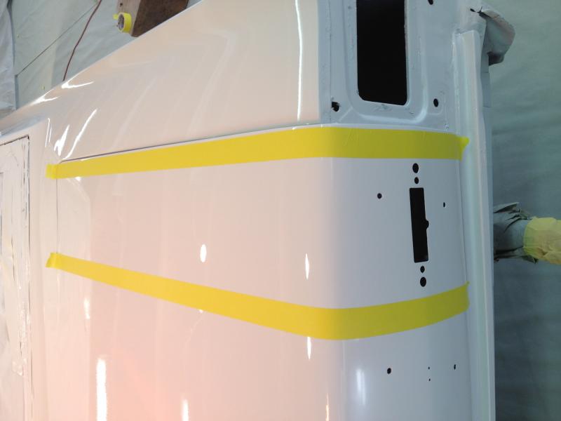

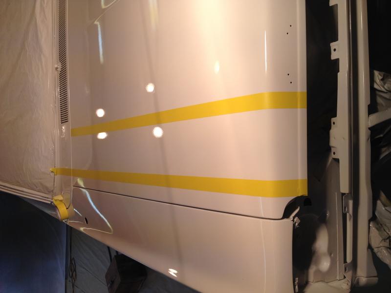

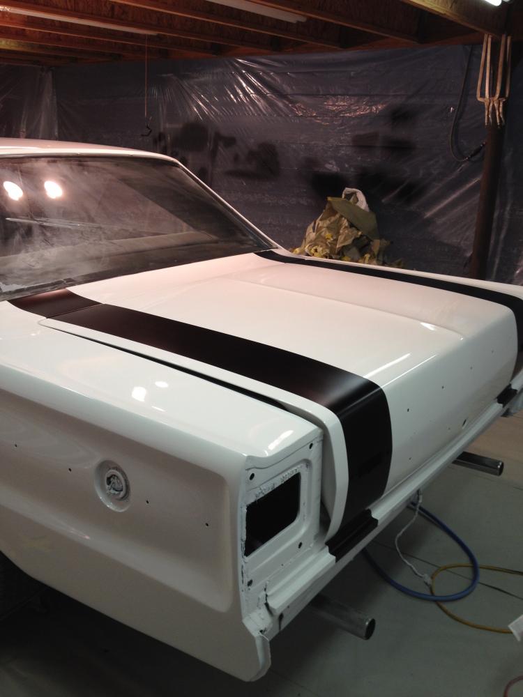

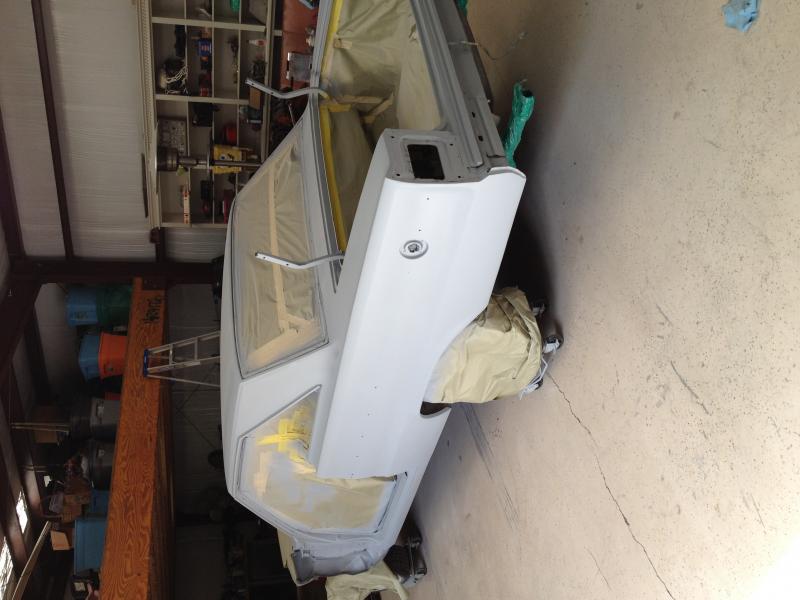

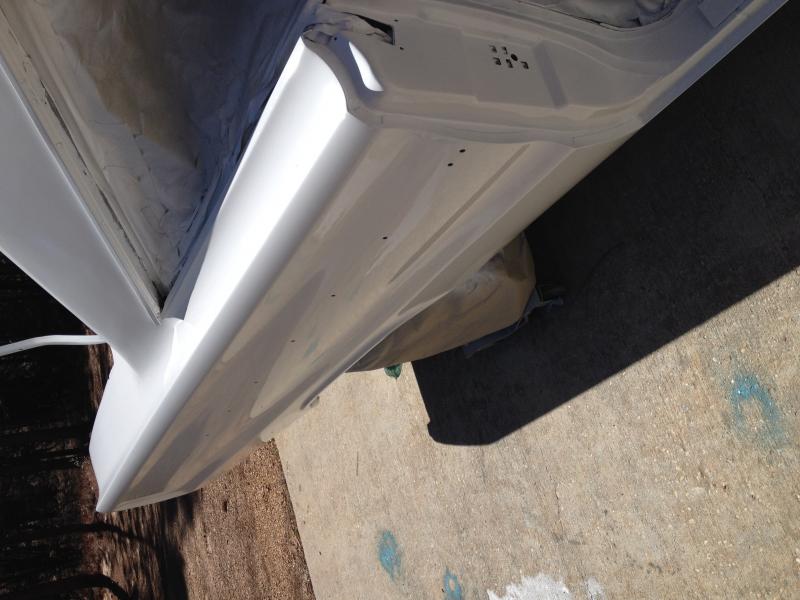

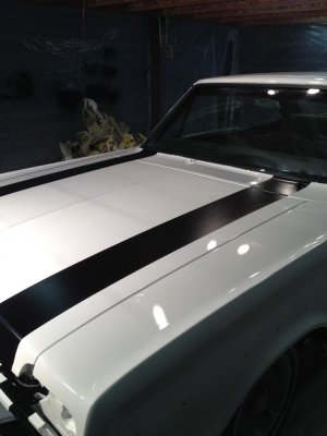

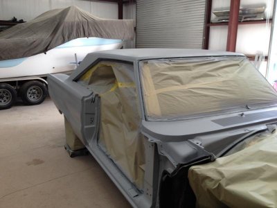

I just painted my wife's '66 Belvedere. It was my first auto body project. I got a lot of help from the local O'Reilys auto parts paint desk.
I could only get the filler so straight. I used a building primer (Euro- Fill, by Evercoat) to build and block the shallow low spots. I tried another primer by Master pro and didn't care for it. The Euro fill can be sanded in less than three hours after spraying. The master pro need a day and a half to cure up before it could be worked.
I used 3M quick grip body filler and it sanded O.K.
I used a two part 3M platinum glaze and loved how easy it was to work with.
I used Nason Full-Thane paint with Nason reducer and Master pro wet look hardener.
If you're spraying pain with a siphon cup sprayer run the pressure about 40psi. If you are using a HVLP gravity feed gun run the pressure Low about 10-15 PSI or you'll get orange peel. I think i used a 1.4 tip in a my HVLP gun
Spraying primer is different. You'll have to practice on a piece of cardboard or sheet metal
Look on Youtube for sanding and building primer suggestions.
When everyone else tells you it looks good block it some more. you'll be your own biggest critic

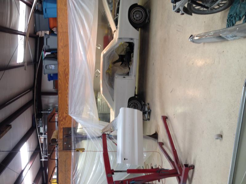

I built a paint booth out of plastic sheeting and duct tape in my shop.
more pics
On more thing. Get some joint pain medicine! You're going to ache when you start block sanding.

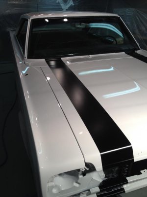

thanks for the compliment. any metal work required was performed using a weld through primer where needed, as well as any hammer and dolly work. after a primary massage, the whole body was stripped and blasted to bare metal, then immediately received a good wet coat of ppg dp epoxy primer/sealer. this was a base for any filler work that needed to be done, as the filler actually adheres to the epoxy better than bare metal. and yes, anywhere I broke through got a recoat to prevent any surface rust flash. after that, lots of priming and blocking with k38 till flat, then sealed with some tinted k93, base, clear, done. the results are in all the prep under the sealer, the base and clear is the easy part.
and btw, half the **** I used i'm sure probably isn't state of the art anymore, or even legal. the current body guys i'm sure will chime in on what the best stuff is now.:headbang:
