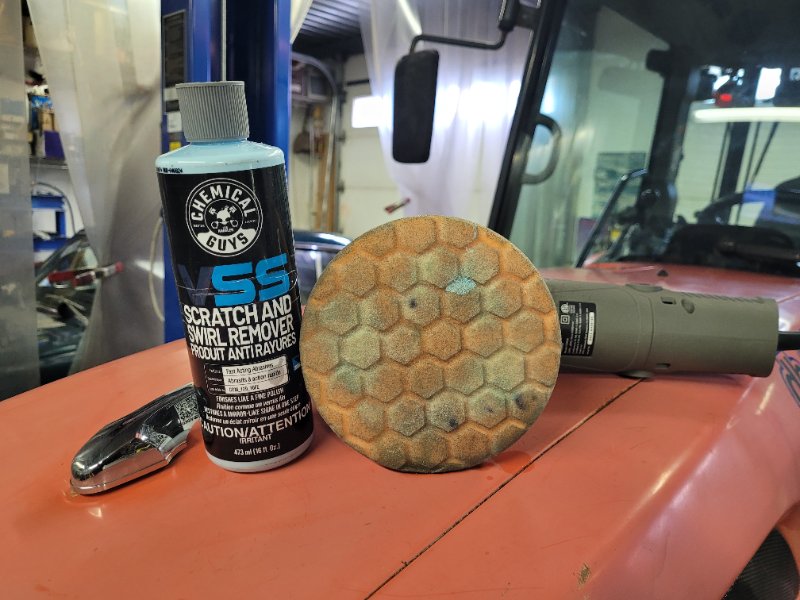

And what do you 'prime' the buffing pad with? I've used mild soap and water but is there something better? Not sure I want to buff my 96 red Dakota which will make it more desirable to thieves or not but would like at least the hood to shine better. Anything after that can be dull lol and why does red go dead so fast! Hate red anyways....
Pad conditioner spray and a few dabs of scratch and swirl remover..
I use Griots Garage paint corrector and best of show wax with their buffer, I used it on my '17 300c and it really made the paint shiny.

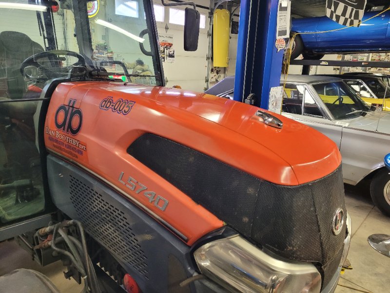

Maybe I'm old school as I'm sure there are fancier products out there these days but I have always used Meguiars 105 Ultra Cut Compound for buffing and Meguiars Fine Cut Cleaner for polishing.
Great results every time. I prime my pads sparingly with a spritz of distilled water. Too much priming and too much compound leads to build up that burns paint. Keep the pads clean, clean, clean and use light pressure.

Look up Griots Garage. They have lots of products for interior to glass and paint. And they have videos. Ive used Meguiars in the past. But it doesn't hold a candle to Griots Garage products.
One reason I like single stage paint. Had a faded red car, polishing compound and elbow grease did the trick.
I've read to get some meguiars paint polish. Wet the entire dull area with it. Let it sit overnight, wipe off. It supposedly rejuvenates dried out oxidized paint. It's worked for me. Keep going until most of the dullness is gone, then compound if needed.
After 25+ years of never buffing the paint, I used Chemical Guys products to give the GTX a good fluff and buff because they offered a "system" of chemicals, pads, compounds, polishes and a pre-wax glaze. Then I finished it off with my preferred wax.
Cranky be careful if that 96 is oem paint it is base clear.
The clear has went dull on you and its thin real thin from that Texas sun.
You want to start with a polish 3m , malco ect. You don't want to start with a compound, use a polish and low speed on your buffer with a fine pad.
Don't heat things up.
Careful of the edges, I always just used the product I was working with to wet the pad.
