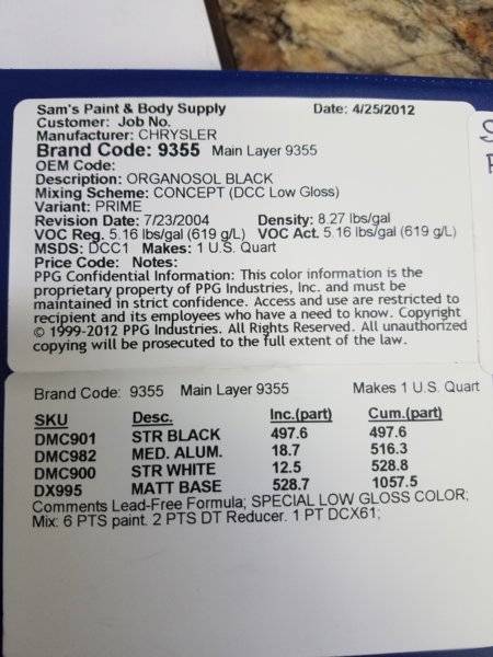

I just recently took a picture of the mix and sent it to moparnation74 in a pm. I accidentally threw it away, but maybe he still has it. Any chance you still have it Justin? @moparnation74
I have a can of the original lacquer Organosol in my shop, but PPG is not selling lacquer any longer from my understanding and the texture is no longer available, hasn't been for 3-4 yrs. PPG is selling Organosol in a Urethane now and it's not correct but it's close. If I can still buy the original lacquer let me know where so I can get some.
Here is where I get my paint. They tell me that they can make the original lacquer mix. Rick is the man to talk to. He is only in Tuesdays and Wednesdays though.
http://www.samspaintandbodysupply.com
lol.....I save everything worth keeping.....ya know me...
